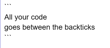

Sorry I know i uploaded the code wrong. It's a learning process
Edit the post and put a line of 3 back ticks ( ` ) above the code, another below the code.
Thanks. for the help
