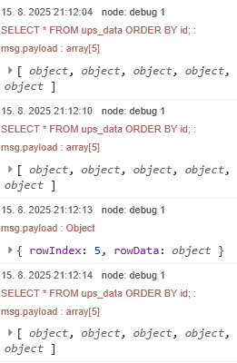

Debug wrote after double click following :
So I do not need repeated Select from SQLITE at output. After dblclick I need only rowIndex statement. Is there a possibility to filter it ?

:frowning: nothing special …. same as I described in first post.
DB data from SQLITE goes as payload to function node and next to tabulator node.
And I don’t need it go thru tabulator to output, but …. still are here. In older dashboard 1 was at most components check box with message : Pass through messages from input. Here I have’n it.

OK - I see in your screen shot - that there is what you need.
rowIndex, rowData
Does the number of array collections (that appears as an addition) match what is in your table row count?
Use a Switch node with property: msg.payload, has key: rowData after the Tabulator node

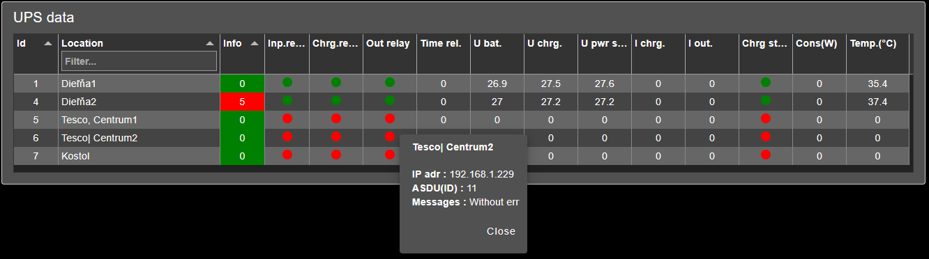

Guys, thanks a lot for every contribution. @Buckskin and @omrid guided me on the right way.
Here is node flow :
And then visualise in table dashboard 2:
