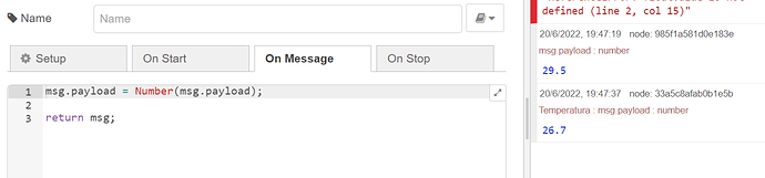

Sorry, I have explained myself wrong.
I am trying to pass a data collected by Blynk to Thingspeak.
Doing tests I see that if I inject a numerical value with a temperature topic, that value is stored in thingspeak.
I see that the way it is stored correctly is with the statement
Temperatura : msg.payload : number
Here Temperature is the topic or field of Thingspeak.
So I need to be able to make that appear, or so I think...
Thank you

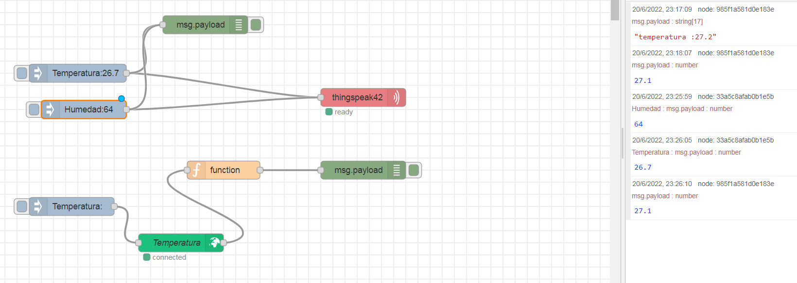

With this solution I was able to introduce the test value in thingspeak, but I don't know how to do it with the function and the Blynk node.
Thank you
I have no experience with the Blynk node but at a guess...
Put a change node before the Blynk node & set msg.topic to "temperature"
Or in the function node
msg.topic = "temperature"
return msg
Thank you, I have solved it with this solution.
