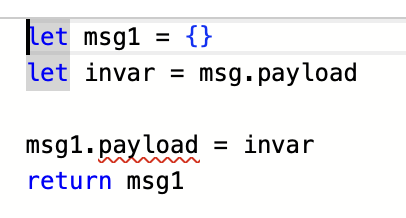

@benoitadam what does it take to make this error disappear in node-red-contrib-ts.
let msg1 = {}
let invar = msg.payload
msg1.payload = invar
return msg1
I use that a lot in function nodes.

What error are you referring to? We cannot see one.
You might get a LINT warning about the use of let instead of const though since you are not resetting the values of either msg1 or invar.
Best shown with a few pictures.
But I've figured out that msg1.payload needs to be declared first.

I think (hard to say without actually seeing the error), it is only Monaco that is highlighting the fact that the payload property is being assigned but it hasn't been defined.
This is pretty much at the heart of what I've been saying about TS. In an enterprise setting with loads of coders and a big code-base, accurately defining the structure of your objects is important for avoiding issues. But typically this is absolutely the opposite of what you want for a quick function node.
The solution for me was
//let msg1 = {}
const msg1 = {
payload: {},
return msg1

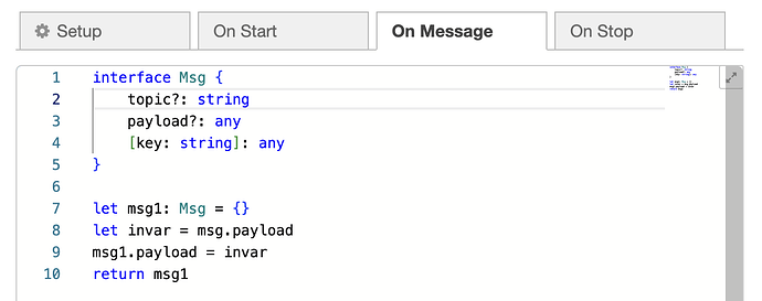

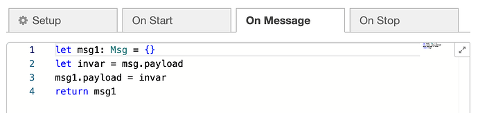

3) Use the built-in MsgBase interface
4) The Msg interface can be customized
interface Msg {
    topic?: string
    payload?: any
    [key: string]: any
let msg1: Msg = {}
return msg1
:light_bulb: Tip
For a smooth migration from JavaScript, approach #1 with any is often the most practical. For more robust code, approach #4 with interfaces offers a good balance between flexibility and type safety.
