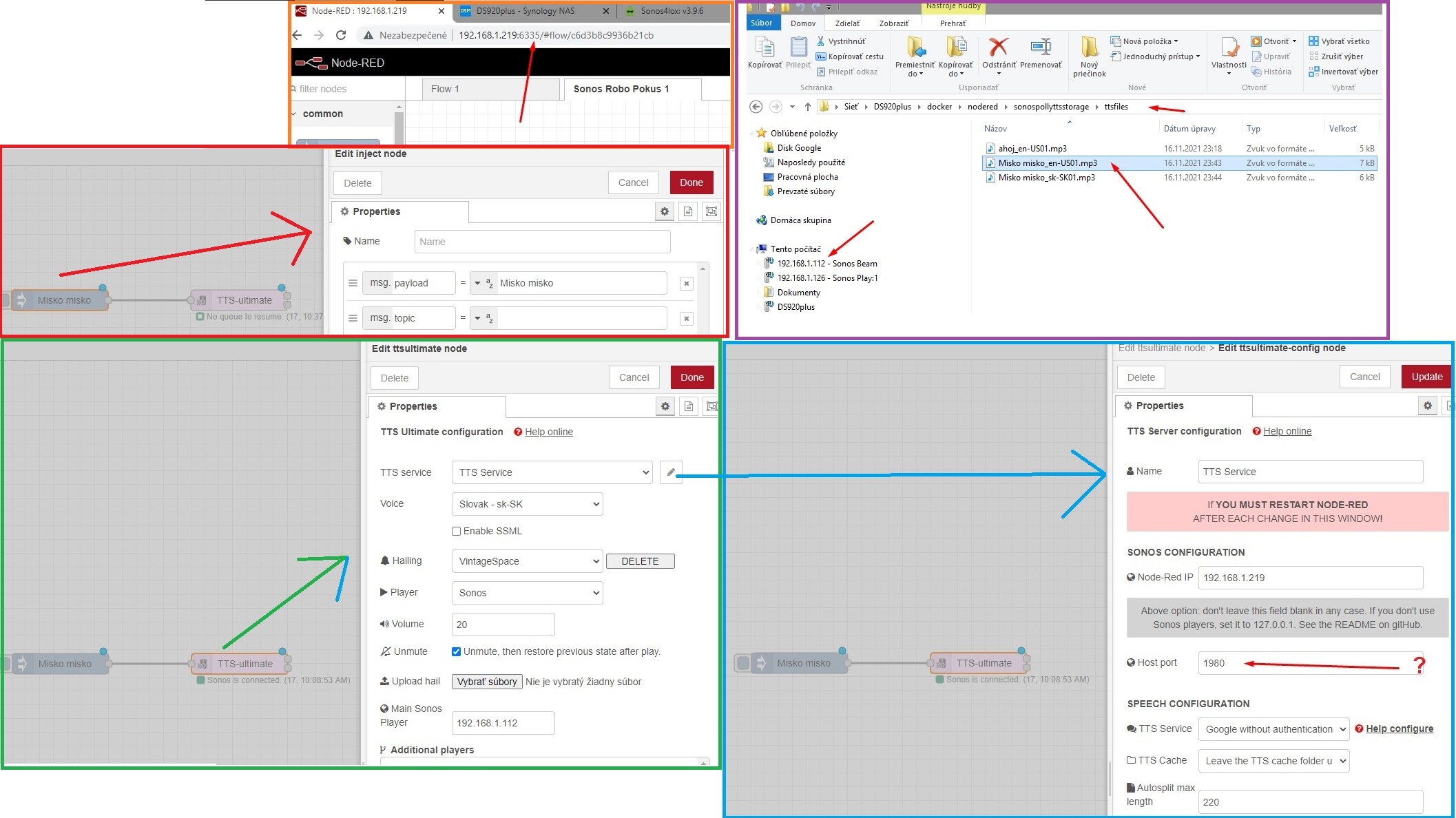

Hi.I am using node-red inside docker container in synology DS920+ and sonos is connected but I can see always some meassages in Sonos app as you can see in below pictures.
Default Host port 1980 in ttsultimate-config node should be port of node-red becasue I have nodered running on port 6335 please?
Thanks for any help...

Finally I reinstal nodered and have to setup in advanced settings during instalation : use same network as host and it is working and nodered run as host network.
Before reinstal I was able to see all TTS mp3 files in shared folder docker in folder nodered as you can see:
But now after reinstal me shared docker folder is empty:
Can you please help me where I can find where it is installed and where all mp3 files are?
Many thanks
