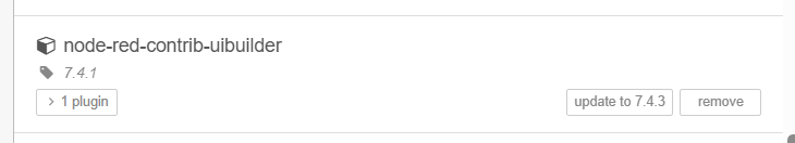

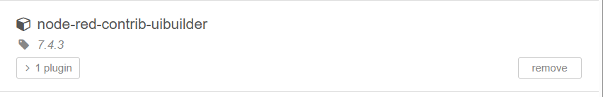

Also, I've noticed now that, in the palette, I'm being given the option to remove uibuilder, despite it being in use in one of my flows (perhaps because it's not getting past configuration, but I wouldn't expect that to be interpreted as a missing node).

As for what you are seeing in Node-RED's palette - there is a bug in all versions of Node-RED that fails to correctly show what nodes are present if there is a mix of nodes and plugins:
On v4.0.9:
On v4.1.0-beta2:

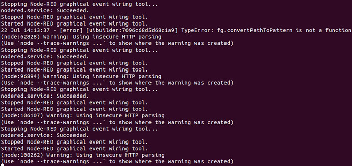

Node-RED log is minimal:

That isn't the node red log. Try
sudo journalctl -f -n 100 -u nodered -o cat
When posting logs please copy/paste rather than screenshot.
