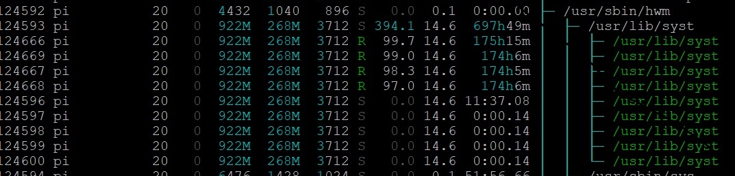

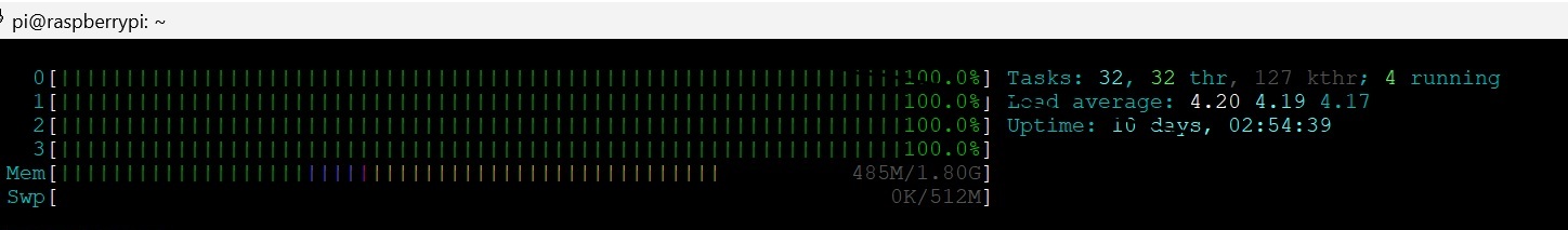

Hallo
ja htop zeigt mir wohl das Problem an
alle 4 kerne vollauslastung
die ursache ist wohl ein update vorgang
4x 100% cpuauslastung, jetzt nur noch warum?
4x 100% is very bad!
It's not Node-red hogging the CPU though, that would be just 1 core at 100%.
Has your Node-red ever been accessible from the internet?
If so, you may have been hacked and it's busy mining crypto.

mosquit+ 584 0.2 0.6 20124 11904 ? Rs Oct10 37:12 /usr/sbin/mosquitto -c /etc/mosquitto/mosquitto.conf
root 593 0.0 0.4 16460 8576 ? Ss Oct10 0:00 sshd: /usr/sbin/sshd -D [listener] 0 of 10-100 startups
pi 64932 1.8 1.1 326284 21040 ? Rsl Oct11 266:41 /home/pi/optolink-splitter-main/myvenv/bin/python /home/pi/optolink-splitter-main/optolink
pi 124592 0.0 0.0 4432 1040 ? Ss Oct12 0:00 /usr/sbin/hwm
pi 124593 373 14.5 944264 275220 ? Sl Oct12 47913:24 /usr/lib/syst
pi 124594 0.4 0.0 6476 1428 ? S Oct12 58:53 /usr/sbin/sys
root 134029 0.0 0.0 0 0 ? I< Oct16 0:00 [kworker/2:0H-kblockd]
root 139271 0.0 0.0 0 0 ? I Oct17 0:02 [kworker/u12:2-events_unbound]
root 139717 0.0 0.0 0 0 ? I Oct17 0:03 [kworker/u11:2-events_unbound]
root 140743 0.0 0.0 0 0 ? I Oct18 0:03 [kworker/u10:1-events_unbound]
root 147400 0.0 0.0 0 0 ? I Oct20 0:01 [kworker/u9:1-events_unbound]
root 149104 0.0 0.0 0 0 ? I Oct20 0:02 [kworker/2:0-cgroup_destroy]
root 149151 0.0 0.0 0 0 ? I Oct20 0:01 [kworker/u9:0-events_unbound]
root 149178 0.0 0.0 0 0 ? I< Oct20 0:00 [kworker/1:0H-kblockd]
root 149185 0.0 0.0 0 0 ? I Oct20 0:01 [kworker/u12:1-events_unbound]
root 149512 0.0 0.0 0 0 ? I Oct20 0:04 [kworker/u9:2-flush-179:0]
root 150844 0.0 0.0 0 0 ? I 09:18 0:00 [kworker/u11:1-events_unbound]
root 150939 0.0 0.0 0 0 ? I 09:52 0:00 [kworker/2:1-mm_percpu_wq]
root 151200 0.0 0.0 0 0 ? I< 11:45 0:00 [kworker/0:2H-kblockd]
pi 151210 0.0 0.1 6800 3072 ? S 11:46 0:00 /bin/bash /home/pi/.node-red/node_modules/node-red-node-pi-gpio/nrgpio out 16 1
pi 151212 0.3 0.6 175596 11392 ? Sl 11:46 1:54 python3 -u /home/pi/.node-red/node_modules/node-red-node-pi-gpio/nrgpio.py out 16 1
root 151854 0.0 0.0 0 0 ? I 17:15 0:00 [kworker/u10:2-events_unbound]
root 151906 0.0 0.0 0 0 ? I 17:41 0:00 [kworker/u11:0-events_unbound]
root 152022 0.0 0.0 0 0 ? I 18:46 0:00 [kworker/u12:0-events_unbound]
root 152083 0.0 0.0 0 0 ? I< 19:19 0:00 [kworker/0:0H]
root 152090 0.0 0.0 0 0 ? I< 19:20 0:00 [kworker/3:2H]
root 152113 0.0 0.0 0 0 ? I 19:33 0:00 [kworker/1:3-events_freezable_power_]
root 152184 0.0 0.0 0 0 ? I 19:54 0:00 [kworker/u10:0]
root 152185 0.0 0.0 0 0 ? I 19:54 0:00 [kworker/1:0-cgroup_destroy]
root 152194 0.0 0.0 0 0 ? I< 19:55 0:00 [kworker/1:2H]
root 152236 0.0 0.0 0 0 ? I 20:18 0:00 [kworker/3:0-mm_percpu_wq]
root 152274 0.0 0.0 0 0 ? I< 20:40 0:00 [kworker/2:2H]
root 152283 0.0 0.5 19592 9984 ? Ss 20:48 0:00 sshd: pi [priv]
pi 152286 0.0 0.5 19596 10112 ? Ss 20:49 0:00 /lib/systemd/systemd --user
pi 152288 0.0 0.2 170332 5052 ? S 20:49 0:00 (sd-pam)
pi 152307 0.0 0.3 19852 6536 ? S 20:49 0:00 sshd: pi@pts/0
pi 152308 0.0 0.2 8100 4608 pts/0 Ss 20:49 0:00 -bash
root 152353 0.0 0.0 0 0 ? I 20:49 0:00 [kworker/0:2-mm_percpu_wq]
root 152400 0.0 0.0 0 0 ? I 20:55 0:00 [kworker/0:1-events]
root 152401 0.0 0.0 0 0 ? I 20:57 0:00 [kworker/3:2-events_freezable]
root 152409 0.2 0.0 0 0 ? I 21:01 0:00 [kworker/0:0-events]
root 152411 0.0 0.0 0 0 ? I 21:02 0:00 [kworker/3:1-mm_percpu_wq]
pi 152420 200 0.2 11136 4224 pts/0 R+ 21:05 0:00 ps -aux
You did not stop node-red before starting it again. You do that by running
node-red-stop
node-red-start
Note, that is node-red-start not node-red start

nach neustart ist cpu auslastung weg!
weil auch der hack gestoppt wurde?
If you do have malware on the Pi it can see user names and passwords for other services such as your mosquitto broker, external API keys etc.
Danke für die Hilfe!
Denke das war kein Hack
Immer noch niedrige Auslastung von ca 3%
Es war wohl eher ein abgestürzte Anwendung oder Update

When you put all that to chatGPT you get:
does anything of this look like the system is compromised, hacked, or running other malishious code? hier mal ein ps -aux ausgabe:...
Short answer: yes — there are a few very suspicious processes here.
Most entries are normal kernel/system threads, but these three jump out:
  • pi 124592 … /usr/sbin/hwm
  • pi 124593 373 … /usr/lib/syst (truncated — likely trying to look like “systemd”)
  • pi 124594 … /usr/sbin/sys
Why they look bad:
  • They’re not standard Raspberry Pi OS/Debian binaries (/usr/sbin/sys and /usr/sbin/hwm don’t exist on a clean install).
  • They’re owned by user pi but live in system directories (/usr/sbin, /usr/lib) — unusual and a common malware trick.
  • One is burning huge CPU (%CPU 373 and TIME in the tens of thousands of minutes), which fits crypto-miner/bot behavior.
  • The names (sys, syst) look like masquerades for real services.
Your other entries like node-red, mosquitto, NetworkManager, wpa_supplicant, ModemManager, sshd, and kernel kworker threads all look normal for a Pi with IoT software.
:puzzle_piece: Schlussfolgerung (auf Deutsch)
Ja — es sieht sehr stark danach aus, dass dein System kompromittiert wurde.
Fast alle Prozesse in deiner ps -aux-Liste sind absolut normal für ein Raspberry-Pi-Linux-System – außer drei Prozessen, die sehr verdächtig sind:
  • /usr/sbin/hwm
  • /usr/lib/syst… (vermutlich absichtlich abgeschnitten, um wie „systemd“ auszusehen)
  • /usr/sbin/sys
Diese drei Programme:
  • liegen in Systemverzeichnissen, gehören aber dem Benutzer „pi“ → das ist ungewöhnlich und deutet auf manipulierte Dateien hin,
  • verwenden täuschende Namen, die wie echte Systemdienste aussehen sollen,
  • einer davon (/usr/lib/syst...) verbraucht extrem viel CPU – ein typisches Verhalten für Krypto-Miner oder Botnet-Software.
Alles andere (Node-RED, mosquitto, NetworkManager, sshd, systemd usw.) ist völlig normal.
