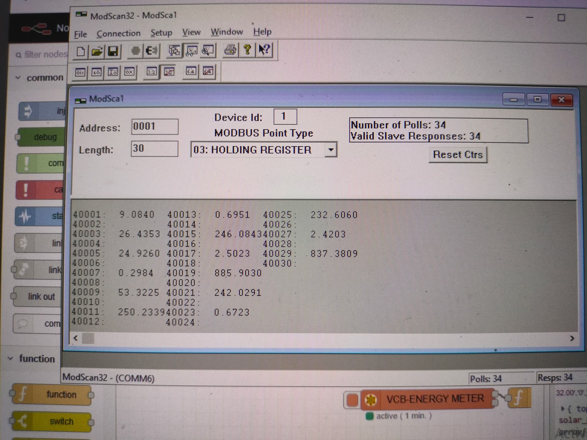

I am getting data from the Modscan. but the same configuration is not working in Node-RED. need help on this situation
Node-RED Version : V4.0.8
Device : CR800 wms data logger
MOC: SerialR232 to USB

Thank you for the reply.
It's is connect via RS232 to usb converter to the windows 10 system.
I assume you cannot connect to the port from Node-RED and the tool at the same time (conflict)
This is just for reference only. I close the Modscan before injecting in Node-RED.
Data Reading in Modscan but same configuration not working in Node-RED
You will need to restart node-red (or do a full deploy) to reinitialise the serial connection.
If that doesn't work, share screenshots of setup details of your node and the scan program.
I have tried to restart Node-red. but the result are same. here i attached the screenshot for your referenec

Sharing only the non working config without any detail is not really helpful.
So we can compare the working config of mobus scan application Vs non working node red.
Also, just as a double check, please confirm when you restarted node-red the modbus scan program was NOT running. In fact, do a restart to ensure the com port is released (and don't open the scan application)
