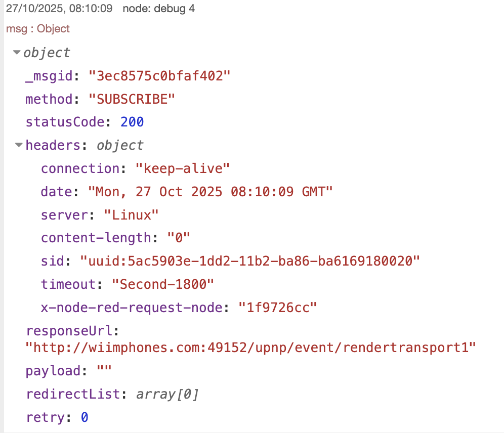

I've spent some time blundering around on this, and with help from @Valimir on the WiiM forum made a little progress. I found a free app for Android, UPnP Tool, which began to unlock the issue. I've managed to get Node-RED to subscribe to the relevant event service (or at least I think I have) but I'm not managing to get to access those events in Node-RED. I say I think I've subscribed successfully, because WiiM responds with:
My SUBSCRIBE http request includes the necessary CALLBACK header (<http://192.168.11.199:24879>), although there's no explicit confirmation in this response. Perhaps that's the problem.

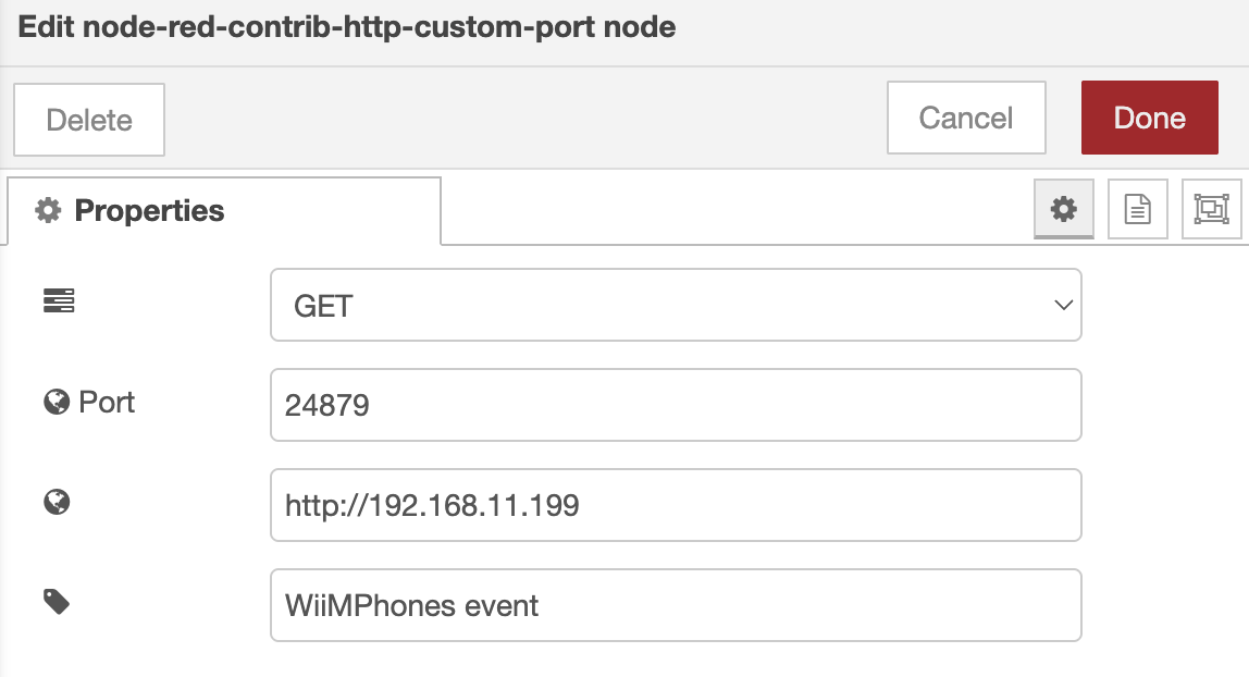

I found Node-RED as standard can't http listen on a port other than the configurable main web port, but a bespoke node (node-red-contrib-http-custom-port) purports to facilitate this. However, I don't get any event notifications listening on this port, and that's where I'm now stuck.
I’ve read that the http in node needs to be able to handle the NOTIFY verb, which the standard and custom port versions do not - is that an insurmountable barrier? @Valimir has made a suggestion I don’t understand, so I’ll struggle to implement. All suggestions are very welcome.
Ah well, Node-RED’s http in simply can’t accept the NOTIFY verb, and I’m accepting that this is an insurmountable barrier. Meanwhile I’ve got a workaround up and running - simply using Home Assistant’s DNLA service to detect changes in the WiiM playing status, and letting NR know. Works for part of I’m after, and I’ll just have to live with the limitations.
