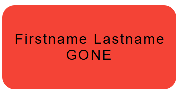

I'm making a program where the button changes status - met / gone and their name above.
So the button should show the full name on the top line, and the status on the bottom line.

{"buttonColor": "green",
"label": "Firstname Lastname<br>MET",
"textColor": "white"}
{"buttonColor": "red",
"label": "Firstname Lastname<br>GONE",
"textColor": "black"}

Maybe your solution is just enough, if putting a semicolon after name in CSV file, and change you code a little I get the result.
But still like answeers to my previous question - just for info.

INFO - Had to remove the last ) so you get ..
Only if someone like me with little coding experience sees this post and could use this example :wink:
payload = 1 ?
"label": $globalContext("myLabel1") & "<br>MET",
"label": $globalContext("myLabel1") & "<br>GONE",
