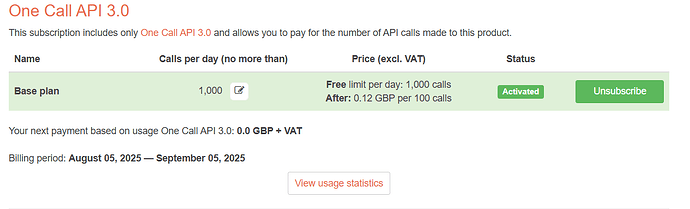

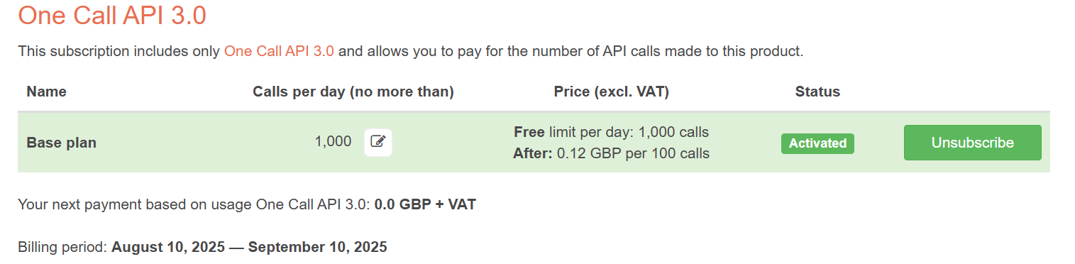

When I sign in to openweathermap it says I have the free plan which does not offer hourly or daily forecasts, and I can't find a URL to access this service. I think this must be out of date.
Apart from that I have an API key (which sits in a global context variable so sharing the flow does not compromise it) which clearly does include hourly and daily forecasts.
It seems that I (also?) have a subscription to their "base plan" for OneCall v3
Presumably I gave them a credit card number to access this.
I do take care not to exceed the free limit of 3000 calls per day
