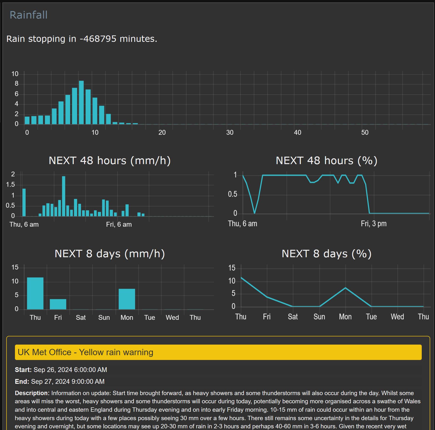

I’m still using OpenWeatherMap, with a simple HTTP request node. It gives everything I need. I have found the rain forecast to be accurate on a par with Apple (previously DarkSky) which was amazing for minutely rain. (I'm basing that on UK weather, specifically W London)
  • 60 minute rain forecast
  • 0-48 hours
  • 0-7 days
Below I’m using alongside Met Office for alerts, but the rain data comes from OpenWeatherMap.
(Ignore the silly “rain stopping” value, I injected dummy data from last year as there’s no rain over the next week here to show!)

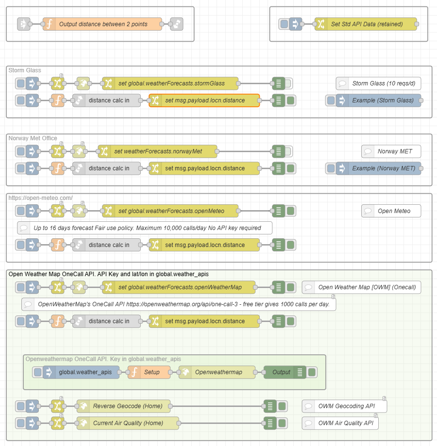

Here are my updated master weather API calls.
I currently have 4 different sources. The 2nd line on each is the start of an attempt to create a standard output set for different sources. Not sure I'll ever complete that though. :slight_smile:
I'm missing the UK Met Office currently, I need to redo that one completely.
The common function node at the top does a rough straight-line distance calculation so that I can see how far away from my real location the forecast is for. In some cases, this can be significant and if, like me, you are somewhere where the weather can change dramatically over a short distance, this may be important.
All the outputs go into a retained global called weatherForecasts. All of the source location and API keys are in a retained global called weather_apis.
[{"id":"4ab807ec65746b11","type":"group","z":"d915a360.b8766","name":"https://open-meteo.com/","style":{"label":true},"nodes":["be82e6132c0c08ba","22e19dbf0931f8dd","a6fbd6322a2dc34d","985bee5f132f2846","bbcf97859e4898ce","973f033802cdcf34","64815a49346ce397","da6960f41c577986","ddd081ffc317457f","c37ff5fb216f3ddf","8577fe53a891b83c","c93dcaa0928d7285"],"x":24,"y":459,"w":1002,"h":162},{"id":"be82e6132c0c08ba","type":"change","z":"d915a360.b8766","g":"4ab807ec65746b11","name":"","rules":[{"t":"set","p":"payload","pt":"msg","to":"(\t   /* Exclude = current,minutely,hourly,daily */\t   \t   $apis := $globalContext(\"weather_apis\", \"file\");\t   \t   {\t       \"latitude\": $apis.lat,\t       \"longitude\": $apis.lon,\t       \"current_weather\": true,\t       \"altitude\": $apis.alt,\t       \"hourly\": \"temperature_2m,relativehumidity_2m,windspeed_10m\"\t   }\t)","tot":"jsonata"},{"t":"set","p":"url","pt":"msg","to":"https://api.open-meteo.com/v1/forecast","tot":"str"},{"t":"set","p":"headers","pt":"msg","to":"{\"Accept\":\"application/json\",\"User-Agent\":\"node-red\"}","tot":"json"}],"action":"","property":"","from":"","to":"","reg":false,"x":145,"y":500,"wires":[["a6fbd6322a2dc34d"]],"l":false},{"id":"22e19dbf0931f8dd","type":"inject","z":"d915a360.b8766","g":"4ab807ec65746b11","name":"","props":[],"repeat":"","crontab":"","once":false,"onceDelay":0.1,"topic":"","x":85,"y":500,"wires":[["be82e6132c0c08ba"]],"l":false},{"id":"a6fbd6322a2dc34d","type":"http request","z":"d915a360.b8766","g":"4ab807ec65746b11","name":"","method":"GET","ret":"obj","paytoqs":"query","url":"","tls":"","persist":false,"proxy":"","insecureHTTPParser":false,"authType":"","senderr":false,"headers":[],"x":195,"y":500,"wires":[["973f033802cdcf34"]],"l":false},{"id":"985bee5f132f2846","type":"debug","z":"d915a360.b8766","g":"4ab807ec65746b11","name":"","active":true,"tosidebar":true,"console":false,"tostatus":false,"complete":"payload","targetType":"msg","statusVal":"","statusType":"auto","x":665,"y":500,"wires":[],"l":false},{"id":"bbcf97859e4898ce","type":"comment","z":"d915a360.b8766","g":"4ab807ec65746b11","name":"Up to 16 days forecast Fair use policy. Maximum 10,000 calls/day No API key required","info":"","x":350,"y":540,"wires":[]},{"id":"973f033802cdcf34","type":"change","z":"d915a360.b8766","g":"4ab807ec65746b11","name":"set global.weatherForecasts.openMeteo","rules":[{"t":"set","p":"#:(file)::weatherForecasts.openMeteo","pt":"global","to":"payload","tot":"msg"},{"t":"set","p":"#:(file)::weatherForecasts.openMeteo.lastUpdate","pt":"global","to":"payload.current_weather.time","tot":"msg"}],"action":"","property":"","from":"","to":"","reg":false,"x":410,"y":500,"wires":[["985bee5f132f2846"]]},{"id":"64815a49346ce397","type":"inject","z":"d915a360.b8766","g":"4ab807ec65746b11","name":"","props":[],"repeat":"","crontab":"","once":false,"onceDelay":0.1,"topic":"","x":85,"y":580,"wires":[["da6960f41c577986"]],"l":false},{"id":"da6960f41c577986","type":"function","z":"d915a360.b8766","g":"4ab807ec65746b11","name":"","func":"const $full = global.get('weatherForecasts.openMeteo', 'file')\n\nmsg.payload = {\n    \"source\": \"Open Meteo API\",\n    \"locn\": {\n        \"lat\": $full.latitude,\n        \"lon\": $full.longitude,\n        \"alt\": $full.elevation,\n        \"name\": \"Broomhill\",\n    },\n    \"updated\": $full.current_weather.time,\n    \"full\": $full,\n    \"distance\": {\n        \"from\": {\n            \"lat\": global.get('weather_apis.lat', 'file'),\n            \"lon\": global.get('weather_apis.lon', 'file'),\n        },\n        \"to\": {\n            \"lat\": $full.latitude,\n            \"lon\": $full.longitude,\n        },\n        \"unit\": \"m\",\n    },\n}\n\nconst forecasts = $full.hourly\n\nconst myNow = new Date() //Date.now()\nconst out = {} //[]\n\nfor (let i = 0; i < forecasts.time.length; i++) {\n    const time = forecasts.time[i]\n    let ts = new Date(time)\n    if (ts >= myNow) {\n        // node.warn(`${i}: ${time}...`)\n        let splitDt = time.split('T')\n        let day = splitDt[0]\n        let hr = splitDt[1].slice(0, 2)\n\n        if (!out[day]) out[day] = {}\n\n        const o = {\n            temperature_2m: forecasts.temperature_2m[i],\n            relativehumidity_2m: forecasts.relativehumidity_2m[i],\n            windspeed_10m: forecasts.windspeed_10m[i],\n        }\n        node.warn(JSON.stringify(o))\n\n        out[day][hr] = o\n    }\n}\n\nmsg.payload.hourly = out\n\nreturn msg","outputs":1,"timeout":"","noerr":0,"initialize":"","finalize":"","libs":[],"x":145,"y":580,"wires":[["c37ff5fb216f3ddf"]],"l":false},{"id":"ddd081ffc317457f","type":"debug","z":"d915a360.b8766","g":"4ab807ec65746b11","name":"","active":true,"tosidebar":true,"console":false,"tostatus":false,"complete":"payload","targetType":"msg","x":665,"y":580,"wires":[],"l":false},{"id":"c37ff5fb216f3ddf","type":"link call","z":"d915a360.b8766","g":"4ab807ec65746b11","name":"","links":["8de8d5547f88456d"],"linkType":"static","timeout":"1","x":260,"y":580,"wires":[["8577fe53a891b83c"]]},{"id":"8577fe53a891b83c","type":"change","z":"d915a360.b8766","g":"4ab807ec65746b11","name":"","rules":[{"t":"set","p":"payload.locn.distance","pt":"msg","to":"payload.distance.howFar","tot":"msg"}],"action":"","property":"","from":"","to":"","reg":false,"x":490,"y":580,"wires":[["ddd081ffc317457f"]]},{"id":"c93dcaa0928d7285","type":"comment","z":"d915a360.b8766","g":"4ab807ec65746b11","name":"Open Meteo","info":"","x":930,"y":500,"wires":[]},{"id":"815941740bc0e964","type":"group","z":"d915a360.b8766","name":"Open Weather Map OneCall API. API Key and lat/lon in global.weather_apis","style":{"label":true,"fill":"#e3f3d3","fill-opacity":"0.29","color":"#000000"},"nodes":["3817c8b2947d01f6","0ac196566feba620","166c313a.49d2ef","a58a05c.aade6f8","e844d1e8.f8585","dbd12e73.be8cb","3bbcfa11.167be6","53c45f68.00321","8e6b9e728b78b1f0","83a5a47c39e68b98","421a1883e4eba346","287017c287456989","72698cef80389b7f","31064ce2e82257f4","71d6dd69d45b7120","6773d1d5260511d7","5a23863cf25592a5","a5b636ef3809c1cc","42cd887b60101b56","aab6e98d2f6c37be","ec2de20d24c3bdbc","47fec5cdcd523dd8"],"x":24,"y":639,"w":1002,"h":282},{"id":"3817c8b2947d01f6","type":"change","z":"d915a360.b8766","g":"815941740bc0e964","name":"","rules":[{"t":"set","p":"url","pt":"msg","to":"(\t    $apis := $globalContext(\"weather_apis\", \"file\");\t    \"http://api.openweathermap.org/data/2.5/air_pollution?lat=\" & $apis.lat & \"&lon=\" & $apis.lon & \"&appid=\" & $apis.keys.owm\t)\t","tot":"jsonata"},{"t":"set","p":"headers","pt":"msg","to":"{\"content-type\":\"application/json\",\"Accept\":\"application/json\",\"User-Agent\":\"node-red\"}","tot":"json"}],"action":"","property":"","from":"","to":"","reg":false,"x":155,"y":880,"wires":[["287017c287456989"]],"l":false},{"id":"0ac196566feba620","type":"inject","z":"d915a360.b8766","g":"815941740bc0e964","name":"","props":[],"repeat":"","crontab":"","once":false,"onceDelay":0.1,"topic":"","x":95,"y":880,"wires":[["3817c8b2947d01f6"]],"l":false},{"id":"166c313a.49d2ef","type":"change","z":"d915a360.b8766","g":"815941740bc0e964","name":"","rules":[{"t":"set","p":"payload","pt":"msg","to":"(\t   /* Exclude = current,minutely,hourly,daily */\t   \t   $apis := $globalContext(\"weather_apis\", \"file\");\t   \t   {\t      \"appid\": $apis.keys.owm,\t      \"lat\": $apis.lat,\t      \"lon\": $apis.lon\t      /*    \"exclude\": \"current,minutely,daily\" */\t   }\t)","tot":"jsonata"},{"t":"set","p":"url","pt":"msg","to":"https://api.openweathermap.org/data/3.0/onecall","tot":"str"},{"t":"set","p":"headers","pt":"msg","to":"{\"content-type\":\"application/json\",\"Accept\":\"application/json\",\"User-Agent\":\"node-red\"}","tot":"json"}],"action":"","property":"","from":"","to":"","reg":false,"x":145,"y":680,"wires":[["e844d1e8.f8585"]],"l":false},{"id":"a58a05c.aade6f8","type":"inject","z":"d915a360.b8766","g":"815941740bc0e964","name":"","props":[],"repeat":"","crontab":"","once":false,"onceDelay":0.1,"topic":"","x":85,"y":680,"wires":[["166c313a.49d2ef"]],"l":false},{"id":"e844d1e8.f8585","type":"http request","z":"d915a360.b8766","g":"815941740bc0e964","name":"","method":"GET","ret":"obj","paytoqs":true,"url":"","tls":"","persist":false,"proxy":"","authType":"","x":195,"y":680,"wires":[["dbd12e73.be8cb"]],"l":false},{"id":"dbd12e73.be8cb","type":"change","z":"d915a360.b8766","g":"815941740bc0e964","name":"set global.weatherForecasts.openWeatherMap","rules":[{"t":"set","p":"#:(file)::weatherForecasts.openWeatherMap","pt":"global","to":"payload","tot":"msg"},{"t":"set","p":"#:(file)::weatherForecasts.openWeatherMap.lastUpdate","pt":"global","to":"","tot":"date"}],"action":"","property":"","from":"","to":"","reg":false,"x":430,"y":680,"wires":[["3bbcfa11.167be6"]]},{"id":"3bbcfa11.167be6","type":"debug","z":"d915a360.b8766","g":"815941740bc0e964","name":"","active":true,"tosidebar":true,"console":false,"tostatus":false,"complete":"payload","targetType":"msg","x":665,"y":680,"wires":[],"l":false},{"id":"53c45f68.00321","type":"comment","z":"d915a360.b8766","g":"815941740bc0e964","name":"Open Weather Map [OWM] (Onecall)","info":"","x":860,"y":680,"wires":[]},{"id":"8e6b9e728b78b1f0","type":"comment","z":"d915a360.b8766","g":"815941740bc0e964","name":"OpenWeatherMap's OneCall API https://openweathermap.org/api/one-call-3 - free tier gives 1000 calls per day.","info":"https://openweathermap.org/api/one-call-3\n\nIcons:\nhttps://flows.nodered.org/flow/d7af9f5d6f6923324466c58ea4f0655f","x":430,"y":720,"wires":[]},{"id":"83a5a47c39e68b98","type":"debug","z":"d915a360.b8766","g":"815941740bc0e964","name":"","active":true,"tosidebar":true,"console":false,"tostatus":false,"complete":"payload.list","targetType":"msg","statusVal":"","statusType":"auto","x":655,"y":880,"wires":[],"l":false},{"id":"421a1883e4eba346","type":"comment","z":"d915a360.b8766","g":"815941740bc0e964","name":"OWM Air Quality API","info":"https://openweathermap.org/api/air-pollution\n\nHere is a description of Air Quality Index levels:\n\n| Qualitative name | Index | Pollutant concentration in μg/m<sup>3</sup> |\n| --- | --- | --- |\n|  | SO<sub>2</sub> | NO<sub>2</sub> | PM<sub>10</sub> | PM<sub>2.5</sub> | O<sub>3</sub> | CO |\n| Good | 1 | \\[0; 20) | \\[0; 40) | \\[0; 20) | \\[0; 10) | \\[0; 60) | \\[0; 4400) |\n| Fair | 2 | \\[20; 80) | \\[40; 70) | \\[20; 50) | \\[10; 25) | \\[60; 100) | \\[4400; 9400) |\n| Moderate | 3 | \\[80; 250) | \\[70; 150) | \\[50; 100) | \\[25; 50) | \\[100; 140) | \\[9400-12400) |\n| Poor | 4 | \\[250; 350) | \\[150; 200) | \\[100; 200) | \\[50; 75) | \\[140; 180) | \\[12400; 15400) |\n| Very Poor | 5 | ⩾350 | ⩾200 | ⩾200 | ⩾75 | ⩾180 | ⩾15400 |","x":820,"y":880,"wires":[]},{"id":"287017c287456989","type":"http request","z":"d915a360.b8766","g":"815941740bc0e964","name":"Current Air Quality (Home)","method":"GET","ret":"obj","paytoqs":"ignore","url":"","tls":"","persist":false,"proxy":"","insecureHTTPParser":false,"authType":"","senderr":false,"headers":[],"x":320,"y":880,"wires":[["83a5a47c39e68b98"]]},{"id":"72698cef80389b7f","type":"debug","z":"d915a360.b8766","g":"815941740bc0e964","name":"","active":true,"tosidebar":true,"console":false,"tostatus":false,"complete":"payload","targetType":"msg","statusVal":"","statusType":"auto","x":655,"y":840,"wires":[],"l":false},{"id":"31064ce2e82257f4","type":"comment","z":"d915a360.b8766","g":"815941740bc0e964","name":"OWM Geocoding API","info":"https://openweathermap.org/api/geocoding-api","x":830,"y":840,"wires":[]},{"id":"71d6dd69d45b7120","type":"inject","z":"d915a360.b8766","g":"815941740bc0e964","name":"","props":[{"p":"lat","v":"#:(file)::weather_apis.lat","vt":"global"},{"p":"lon","v":"#:(file)::weather_apis.lon","vt":"global"},{"p":"lat","v":"53.38","vt":"str"},{"p":"lon","v":"-1.5","vt":"str"}],"repeat":"","crontab":"","once":false,"onceDelay":0.1,"topic":"","x":95,"y":840,"wires":[["6773d1d5260511d7"]],"l":false},{"id":"6773d1d5260511d7","type":"change","z":"d915a360.b8766","g":"815941740bc0e964","name":"","rules":[{"t":"set","p":"url","pt":"msg","to":"(\t    $apis := $globalContext(\"weather_apis\", \"file\");\t    \"http://api.openweathermap.org/geo/1.0/reverse?lat=\" & lat & \"&lon=\" & lon & \"&limit=10&appid=\" & $apis.keys.owm\t)\t","tot":"jsonata"},{"t":"set","p":"headers","pt":"msg","to":"{\"content-type\":\"application/json\",\"Accept\":\"application/json\",\"User-Agent\":\"node-red\"}","tot":"json"}],"action":"","property":"","from":"","to":"","reg":false,"x":155,"y":840,"wires":[["5a23863cf25592a5"]],"l":false,"info":"https://developer.climacell.co/v3/reference#get-realtime\n\nhttps://developer.climacell.co/v3/docs/present\n\nhttps://developer.climacell.co/v3/widgets"},{"id":"5a23863cf25592a5","type":"http request","z":"d915a360.b8766","g":"815941740bc0e964","name":"Reverse Geocode (Home)","method":"GET","ret":"obj","paytoqs":"ignore","url":"","tls":"","persist":false,"proxy":"","insecureHTTPParser":false,"authType":"","senderr":false,"headers":[],"x":310,"y":840,"wires":[["72698cef80389b7f"]]},{"id":"a5b636ef3809c1cc","type":"inject","z":"d915a360.b8766","g":"815941740bc0e964","name":"","props":[],"repeat":"","crontab":"","once":false,"onceDelay":0.1,"topic":"","x":85,"y":760,"wires":[["42cd887b60101b56"]],"l":false},{"id":"42cd887b60101b56","type":"function","z":"d915a360.b8766","g":"815941740bc0e964","name":"","func":"const $full = global.get('weatherForecasts.openMeteo', 'file')\n\nmsg.payload = {\n    \"source\": \"Open Meteo API\",\n    \"locn\": {\n        \"lat\": $full.latitude,\n        \"lon\": $full.longitude,\n        \"alt\": $full.elevation,\n        \"name\": \"Broomhill\",\n    },\n    \"updated\": $full.current_weather.time,\n    \"full\": $full,\n    \"distance\": {\n        \"from\": {\n            \"lat\": global.get('weather_apis.lat', 'file'),\n            \"lon\": global.get('weather_apis.lon', 'file'),\n        },\n        \"to\": {\n            \"lat\": $full.latitude,\n            \"lon\": $full.longitude,\n        },\n        \"unit\": \"m\",\n    },\n}\n\nconst forecasts = $full.hourly\n\nconst myNow = new Date() //Date.now()\nconst out = {} //[]\n\nfor (let i = 0; i < forecasts.time.length; i++) {\n    const time = forecasts.time[i]\n    let ts = new Date(time)\n    if (ts >= myNow) {\n        // node.warn(`${i}: ${time}...`)\n        let splitDt = time.split('T')\n        let day = splitDt[0]\n        let hr = splitDt[1].slice(0, 2)\n\n        if (!out[day]) out[day] = {}\n\n        const o = {\n            temperature_2m: forecasts.temperature_2m[i],\n            relativehumidity_2m: forecasts.relativehumidity_2m[i],\n            windspeed_10m: forecasts.windspeed_10m[i],\n        }\n        node.warn(JSON.stringify(o))\n\n        out[day][hr] = o\n    }\n}\n\nmsg.payload.hourly = out\n\nreturn msg","outputs":1,"timeout":"","noerr":0,"initialize":"","finalize":"","libs":[],"x":145,"y":760,"wires":[["ec2de20d24c3bdbc"]],"l":false},{"id":"aab6e98d2f6c37be","type":"debug","z":"d915a360.b8766","g":"815941740bc0e964","name":"","active":true,"tosidebar":true,"console":false,"tostatus":false,"complete":"payload","targetType":"msg","x":665,"y":760,"wires":[],"l":false},{"id":"ec2de20d24c3bdbc","type":"link call","z":"d915a360.b8766","g":"815941740bc0e964","name":"","links":["8de8d5547f88456d"],"linkType":"static","timeout":"1","x":260,"y":760,"wires":[["47fec5cdcd523dd8"]]},{"id":"47fec5cdcd523dd8","type":"change","z":"d915a360.b8766","g":"815941740bc0e964","name":"","rules":[{"t":"set","p":"payload.locn.distance","pt":"msg","to":"payload.distance.howFar","tot":"msg"}],"action":"","property":"","from":"","to":"","reg":false,"x":490,"y":760,"wires":[["aab6e98d2f6c37be"]]},{"id":"9f00354b1491eeb3","type":"group","z":"d915a360.b8766","name":"Storm Glass","style":{"label":true},"nodes":["73306a5b.3dfd54","52baafeb.8eab6","abc3fd14.e68ce","a12a90b1.06532","32229272.65d27e","b990f32.16efe1","825825.0d06a7d8","1514d2cc.85660d","d43a5845.c079e8","7dc6301173a5ab60","3bd0fc58cf80745e"],"x":24,"y":159,"w":1002,"h":122},{"id":"73306a5b.3dfd54","type":"change","z":"d915a360.b8766","g":"9f00354b1491eeb3","name":"","rules":[{"t":"set","p":"payload","pt":"msg","to":"(\t   /* https://docs.stormglass.io/#/weather */\t    \t   $apis := $globalContext(\"weather_apis\", \"file\");\t\t   $params := [\t      \"airTemperature\",\t      \"airTemperature80m\",\t      \"airTemperature100m\",\t      \"airTemperature1000hpa\",\t      \"airTemperature800hpa\",\t      \"airTemperature500hpa\",\t      \"airTemperature200hpa\",\t      \"pressure\",\t      \"cloudCover\",\t      \"currentDirection\",\t      \"currentSpeed\",\t      \"gust\",\t      \"humidity\",\t      \"iceCover\",\t      \"precipitation\",\t      \"snowDepth\",\t      \"seaLevel\",\t      \"swellDirection\",\t      \"swellHeight\",\t      \"swellPeriod\",\t      \"secondarySwellPeriod\",\t      \"secondarySwellDirection\",\t      \"secondarySwellHeight\",\t      /*\"visiblity\",*/\t      \"waterTemperature\",\t      \"waveDirection\",\t      \"waveHeight\",\t      \"wavePeriod\",\t      \"windWaveDirection\",\t      \"windWaveHeight\",\t      \"windWavePeriod\",\t      \"windDirection\",\t      \"windDirection20m\",\t      \"windDirection30m\",\t      \"windDirection40m\",\t      \"windDirection50m\",\t      \"windDirection80m\",\t      \"windDirection100m\",\t      \"windDirection1000hpa\",\t      \"windDirection800hpa\",\t      \"windDirection500hpa\",\t      \"windDirection200hpa\",\t      \"windSpeed\",\t      \"windSpeed20m\",\t      \"windSpeed30m\",\t      \"windSpeed40m\",\t      \"windSpeed50m\",\t      \"windSpeed80m\",\t      \"windSpeed100m\",\t      \"windSpeed1000hpa\",\t      \"windSpeed800hpa\",\t      \"windSpeed500hpa\",\t      \"windSpeed200hpa\"\t   ];\t   \t   {\t      \"lat\": $apis.lat,\t      \"lng\": $apis.lon,\t      \"params\": $join($params, \",\"),\t      \"start\": $now()\t   }\t)","tot":"jsonata"},{"t":"set","p":"url","pt":"msg","to":"https://api.stormglass.io/v2/weather/point","tot":"str"},{"t":"set","p":"headers","pt":"msg","to":"(\t    $apis := $globalContext(\"weather_apis\", \"file\");\t\t    {\t        \"Authorization\": $apis.keys.stormglass,\t        \"content-type\":\"application/json\",\t        \"Accept\":\"application/json\",\t        \"User-Agent\":\"node-red\"\t    }\t)","tot":"jsonata"}],"action":"","property":"","from":"","to":"","reg":false,"x":145,"y":200,"wires":[["abc3fd14.e68ce"]],"l":false},{"id":"52baafeb.8eab6","type":"inject","z":"d915a360.b8766","g":"9f00354b1491eeb3","name":"","props":[],"repeat":"","crontab":"","once":false,"onceDelay":0.1,"topic":"","x":85,"y":200,"wires":[["73306a5b.3dfd54"]],"l":false},{"id":"abc3fd14.e68ce","type":"http request","z":"d915a360.b8766","g":"9f00354b1491eeb3","name":"","method":"GET","ret":"obj","paytoqs":true,"url":"","tls":"","persist":false,"proxy":"","authType":"","x":205,"y":200,"wires":[["a12a90b1.06532"]],"l":false},{"id":"a12a90b1.06532","type":"change","z":"d915a360.b8766","g":"9f00354b1491eeb3","name":"set global.weatherForecasts.stormGlass","rules":[{"t":"set","p":"#:(file)::weatherForecasts.stormGlass","pt":"global","to":"payload","tot":"msg"},{"t":"set","p":"weatherForecasts.stormGlass.lastUpdate","pt":"msg","to":"payload.meta.start","tot":"msg"}],"action":"","property":"","from":"","to":"","reg":false,"x":410,"y":200,"wires":[["32229272.65d27e"]]},{"id":"32229272.65d27e","type":"debug","z":"d915a360.b8766","g":"9f00354b1491eeb3","name":"","active":false,"tosidebar":true,"console":false,"tostatus":false,"complete":"payload","targetType":"msg","x":665,"y":200,"wires":[],"l":false},{"id":"b990f32.16efe1","type":"inject","z":"d915a360.b8766","g":"9f00354b1491eeb3","name":"","props":[],"repeat":"","crontab":"","once":false,"onceDelay":0.1,"topic":"","x":85,"y":240,"wires":[["1514d2cc.85660d"]],"l":false},{"id":"825825.0d06a7d8","type":"debug","z":"d915a360.b8766","g":"9f00354b1491eeb3","name":"","active":true,"tosidebar":true,"console":false,"tostatus":false,"complete":"payload","targetType":"msg","x":665,"y":240,"wires":[],"l":false},{"id":"1514d2cc.85660d","type":"function","z":"d915a360.b8766","g":"9f00354b1491eeb3","name":"","func":"/* https://docs.stormglass.io/#/weather */\n\nconst    $full = global.get('weatherForecasts.stormGlass', 'file')\n\nmsg.payload = {\n    \"source\": \"Stormglass Weather API\",\n    \"locn\": {\n        \"lat\": $full.meta.lat,\n        \"lon\": $full.meta.lng,\n        \"alt\": global.get('weather_apis.alt', 'file'),\n        \"name\": \"Home\",\n    },\n    \"updated\": $full.hours[0].time,\n    \"full\": $full,\n    \"distance\": {\n        \"from\": {\n            \"lat\": global.get('weather_apis.lat', 'file'),\n            \"lon\": global.get('weather_apis.lon', 'file'),\n        },\n        \"to\": {\n            \"lat\": $full.meta.lat,\n            \"lon\": $full.meta.lng,\n        },\n        \"unit\": \"m\",\n        \"howFar\": 0,\n    },\n}\n\nconst forecasts = $full.hours\n\nconst myNow = new Date() //Date.now()\nconst out = {} //[]\n\nforecasts.forEach( obj => {\n    const time = obj.time\n    let ts = new Date(time)\n    if ( ts < myNow) return\n    \n    let splitDt = time.split('T')\n    let day = splitDt[0]\n    let hr = splitDt[1].slice(0,2)\n    \n    if ( ! out[day] ) out[day] = {}\n    \n    const o = out[day][hr] = {}\n    \n    const inp = obj  // in case we need to drill deeper to get the data\n    \n    Object.keys(inp).forEach( key => {\n        // Which bits to throw away\n        if ( key === 'time' ) return\n        \n        const newKey = key // Allow for renaming keys\n        \n        if ( inp[key].sg ) o[newKey] = inp[key].sg\n        else if ( inp[key].dwd ) o[newKey] = inp[key].dwd\n        else if ( inp[key].noaa ) o[newKey] = inp[key].noaa\n    })\n    \n})\n\nmsg.payload.hours = out\n\nreturn msg","outputs":1,"timeout":"","noerr":0,"initialize":"","finalize":"","libs":[],"x":145,"y":240,"wires":[["825825.0d06a7d8"]],"l":false},{"id":"d43a5845.c079e8","type":"comment","z":"d915a360.b8766","g":"9f00354b1491eeb3","name":"Storm Glass (10 reqs/d)","info":"","x":900,"y":200,"wires":[]},{"id":"7dc6301173a5ab60","type":"link call","z":"d915a360.b8766","g":"9f00354b1491eeb3","name":"","links":["8de8d5547f88456d"],"linkType":"static","timeout":"1","x":260,"y":240,"wires":[["3bd0fc58cf80745e"]]},{"id":"3bd0fc58cf80745e","type":"change","z":"d915a360.b8766","g":"9f00354b1491eeb3","name":"set msg.payload.locn.distance","rules":[{"t":"set","p":"payload.locn.distance","pt":"msg","to":"0","tot":"num"}],"action":"","property":"","from":"","to":"","reg":false,"x":490,"y":240,"wires":[[]]},{"id":"d2034c44d488b76c","type":"group","z":"d915a360.b8766","name":"Norway Met Office","style":{"label":true},"nodes":["3f8f794d.c746d6","efbfede3.dd015","25f169ec.5d3956","ef42304a.2a60a","f82d1f8e.bc4fd","ee8a2648.6e4eb8","99eb6f4.1640c9","39e82d5e.a146c2","1cf90e57.32d332","4786801ceb348a72","86a872feaccb4b7d"],"x":24,"y":319,"w":1002,"h":122},{"id":"3f8f794d.c746d6","type":"change","z":"d915a360.b8766","g":"d2034c44d488b76c","name":"","rules":[{"t":"set","p":"payload","pt":"msg","to":"(\t    $apis := $globalContext('weather_apis');\t\t    {\t        \"lat\": $apis.lat,\t        \"lon\": $apis.lon,\t        \"altitude\": $apis.alt\t    }\t)","tot":"jsonata"},{"t":"set","p":"url","pt":"msg","to":"https://api.met.no/weatherapi/locationforecast/2.0/complete.json","tot":"str"},{"t":"set","p":"headers","pt":"msg","to":"{\"Accept\":\"application/json\",\"User-Agent\":\"node-red\"}","tot":"json"}],"action":"","property":"","from":"","to":"","reg":false,"x":145,"y":360,"wires":[["25f169ec.5d3956"]],"l":false,"info":"https://api.met.no/weatherapi/documentation"},{"id":"efbfede3.dd015","type":"inject","z":"d915a360.b8766","g":"d2034c44d488b76c","name":"","props":[],"repeat":"","crontab":"","once":false,"onceDelay":0.1,"topic":"","x":85,"y":360,"wires":[["3f8f794d.c746d6"]],"l":false},{"id":"25f169ec.5d3956","type":"http request","z":"d915a360.b8766","g":"d2034c44d488b76c","name":"","method":"GET","ret":"obj","paytoqs":"query","url":"","tls":"","persist":false,"proxy":"","insecureHTTPParser":false,"authType":"","senderr":false,"headers":[],"x":195,"y":360,"wires":[["ef42304a.2a60a"]],"l":false},{"id":"ef42304a.2a60a","type":"change","z":"d915a360.b8766","g":"d2034c44d488b76c","name":"set weatherForecasts.norwayMet","rules":[{"t":"set","p":"#:(file)::weatherForecasts.norwayMet","pt":"global","to":"payload","tot":"msg"},{"t":"set","p":"#:(file)::weatherForecasts.norwayMet.lastUpdate","pt":"global","to":"payload.properties.meta.updated_at","tot":"msg"}],"action":"","property":"","from":"","to":"","reg":false,"x":380,"y":360,"wires":[["f82d1f8e.bc4fd"]]},{"id":"f82d1f8e.bc4fd","type":"debug","z":"d915a360.b8766","g":"d2034c44d488b76c","name":"","active":false,"tosidebar":true,"console":false,"tostatus":false,"complete":"payload","targetType":"msg","x":665,"y":360,"wires":[],"l":false},{"id":"ee8a2648.6e4eb8","type":"inject","z":"d915a360.b8766","g":"d2034c44d488b76c","name":"","props":[],"repeat":"","crontab":"","once":false,"onceDelay":0.1,"topic":"","x":85,"y":400,"wires":[["39e82d5e.a146c2"]],"l":false},{"id":"99eb6f4.1640c9","type":"debug","z":"d915a360.b8766","g":"d2034c44d488b76c","name":"","active":true,"tosidebar":true,"console":false,"tostatus":false,"complete":"payload","targetType":"msg","x":665,"y":400,"wires":[],"l":false},{"id":"39e82d5e.a146c2","type":"function","z":"d915a360.b8766","g":"d2034c44d488b76c","name":"","func":"const $full = global.get('weatherForecasts.norwayMet', 'file')\n\nmsg.payload = {\n    \"source\": \"Norway MET Weather API\",\n    \"locn\": {\n        \"lat\": $full.geometry.coordinates[1],\n        \"lon\": $full.geometry.coordinates[0],\n        \"alt\": $full.geometry.coordinates[2],\n        \"name\": \"Home\"\n    },\n    \"updated\": $full.properties.meta.updated_at,\n    \"full\": $full,\n    \"distance\": {\n        \"from\": {\n            \"lat\": global.get('weather_apis.lat', 'file'),\n            \"lon\": global.get('weather_apis.lon', 'file'),\n        },\n        \"to\": {\n            \"lat\": $full.geometry.coordinates[1],\n            \"lon\": $full.geometry.coordinates[0]\n        },\n        \"unit\": \"m\"\n    }\n}\n\nconst forecasts = $full.properties.timeseries\n\nconst myNow = new Date() //Date.now()\nconst out = {} //[]\n\nforecasts.forEach( obj => {\n    const time = obj.time\n    let ts = new Date(time)\n    if ( ts < myNow) return\n    \n    let splitDt = time.split('T')\n    let day = splitDt[0]\n    let hr = splitDt[1].slice(0,2)\n    \n    if ( ! out[day] ) out[day] = {}\n    \n    const o = out[day][hr] = {}\n    \n    const inp = obj.data.instant.details\n    \n    Object.keys(inp).forEach( key => {\n        // Which bits to throw away\n        if ( key === 'time' ) return\n        \n        const newKey = key // Allow for renaming keys\n        \n        o[newKey] = inp[key]\n    })\n    \n    if ( obj.data.next_1_hours ) {\n        o.next_hour = {}\n        o.next_hour.summary = obj.data.next_1_hours.summary.symbol_code\n        \n        o.next_hour.precipitation_amount = obj.data.next_1_hours.details.precipitation_amount\n    }\n})\n\nmsg.payload.hourly = out\n\nreturn msg","outputs":1,"timeout":"","noerr":0,"initialize":"","finalize":"","libs":[],"x":145,"y":400,"wires":[["4786801ceb348a72"]],"l":false},{"id":"1cf90e57.32d332","type":"comment","z":"d915a360.b8766","g":"d2034c44d488b76c","name":"Norway MET","info":"","x":930,"y":360,"wires":[]},{"id":"4786801ceb348a72","type":"link call","z":"d915a360.b8766","g":"d2034c44d488b76c","name":"","links":["8de8d5547f88456d"],"linkType":"static","timeout":"1","x":260,"y":400,"wires":[["86a872feaccb4b7d"]]},{"id":"86a872feaccb4b7d","type":"change","z":"d915a360.b8766","g":"d2034c44d488b76c","name":"","rules":[{"t":"set","p":"payload.locn.distance","pt":"msg","to":"payload.distance.howFar","tot":"msg"}],"action":"","property":"","from":"","to":"","reg":false,"x":490,"y":400,"wires":[["99eb6f4.1640c9"]]},{"id":"f58e0f157b6ecc7e","type":"group","z":"d915a360.b8766","style":{"stroke":"#999999","stroke-opacity":"1","fill":"none","fill-opacity":"1","label":true,"label-position":"nw","color":"#a4a4a4"},"nodes":["e2a9f98faf258b5c","8de8d5547f88456d","add2b9c307d4eddd"],"x":24,"y":19,"w":442,"h":82},{"id":"e2a9f98faf258b5c","type":"function","z":"d915a360.b8766","g":"f58e0f157b6ecc7e","name":"Output distance between 2 points","func":"function calculateDistance(lat1, lon1, lat2, lon2, unit = 'km') {\n    lat1 = parseFloat(lat1)\n    lon1 = parseFloat(lon1)\n    lat2 = parseFloat(lat2)\n    lon2 = parseFloat(lon2)\n    // Validate input parameters\n    if (typeof lat1 !== 'number' || typeof lon1 !== 'number'\n        || typeof lat2 !== 'number' || typeof lon2 !== 'number') {\n        throw new Error('All coordinates must be numbers')\n    }\n\n    if (lat1 < -90 || lat1 > 90 || lat2 < -90 || lat2 > 90) {\n        throw new Error('Latitude must be between -90 and 90 degrees')\n    }\n\n    if (lon1 < -180 || lon1 > 180 || lon2 < -180 || lon2 > 180) {\n        throw new Error('Longitude must be between -180 and 180 degrees')\n    }\n\n    // Earth's radius in kilometers\n    const earthRadiusKm = 6371\n\n    // Convert degrees to radians\n    const lat1Rad = lat1 * Math.PI / 180\n    const lon1Rad = lon1 * Math.PI / 180\n    const lat2Rad = lat2 * Math.PI / 180\n    const lon2Rad = lon2 * Math.PI / 180\n\n    // Calculate differences\n    const deltaLat = lat2Rad - lat1Rad\n    const deltaLon = lon2Rad - lon1Rad\n\n    // Haversine formula\n    const a = Math.sin(deltaLat / 2) * Math.sin(deltaLat / 2)\n        + Math.cos(lat1Rad) * Math.cos(lat2Rad)\n        * Math.sin(deltaLon / 2) * Math.sin(deltaLon / 2)\n\n    const c = 2 * Math.atan2(Math.sqrt(a), Math.sqrt(1 - a))\n\n    // Distance in kilometers\n    const distanceKm = earthRadiusKm * c\n\n    let outDist\n\n    // Convert to requested unit\n    switch (unit.toLowerCase()) {\n        case 'km':\n            outDist = distanceKm\n            break\n        case 'mi':\n            outDist = distanceKm * 0.621371\n            break\n        case 'm':\n            outDist = distanceKm * 1000\n            break\n        default:\n            throw new Error('Unit must be \"km\", \"mi\", or \"m\"')\n    }\n    return Math.round(outDist) ?? 0\n}\n\nmsg.payload.distance.howFar = calculateDistance(\n    msg.payload.distance.from.lat, msg.payload.distance.from.lon,\n    msg.payload.distance.to.lat, msg.payload.distance.to.lon,\n    msg.payload.distance.unit ?? 'km'\n)\n\nreturn msg;","outputs":1,"timeout":0,"noerr":0,"initialize":"","finalize":"","libs":[],"x":250,"y":60,"wires":[["add2b9c307d4eddd"]]},{"id":"8de8d5547f88456d","type":"link in","z":"d915a360.b8766","g":"f58e0f157b6ecc7e","name":"distance calc in","links":[],"x":65,"y":60,"wires":[["e2a9f98faf258b5c"]]},{"id":"add2b9c307d4eddd","type":"link out","z":"d915a360.b8766","g":"f58e0f157b6ecc7e","name":"distance out","mode":"return","links":[],"x":425,"y":60,"wires":[]}]

That's why mine use a standard global context variable for all the sensitive bits. The keys, and my actual location. That way I can always copy the flows and freely share them.

Here's my 48 hour rain function. I just feed this function into a Dashboard template chart node:
// minutely[x].precipitation is measured in mm / h
var m = {};
m.data = [[]]
m.data[0] = []
m.labels = []
 * Converts a timestamp to a human-readable format, showing just the time if the date is today,
 * or the abbreviated day and time if it's tomorrow or later.
 * - For today's date, it returns the time (e.g., "3 PM").
 * - For any future date, including tomorrow, it returns the abbreviated day of the week followed by the time (e.g., "Wed, 3 PM").
 * - Special cases: "Midnight" for 00:00 and "Midday" for 12:00.
 * @param {number} dt - Unix timestamp (in seconds) to be converted.
 * @return {string} - Formatted date string for chart display.
function readableDate(dt) {
        const date = new Date(dt * 1000);
        const now = new Date();
        const isToday = date.getDate() === now.getDate() &&
                date.getMonth() === now.getMonth() &&
                date.getFullYear() === now.getFullYear();
        const hours = date.getHours();
        let timeString;
        if (hours === 0) {
                timeString = "Midnight";  // Special case for midnight
        } else if (hours === 12) {
                timeString = "Midday";    // Special case for midday
        } else {
                // Format other times as "3 AM", "4 PM", etc.
                timeString = date.toLocaleString('en-GB', {
                        hour: 'numeric',
                        minute: 'numeric',
                        hour12: true,
                        timeZone: 'Europe/London'
                }).replace(':00', ''); // Remove minutes if zero
        if (isToday) {
                return timeString;  // Only show time for today
        } else {
                return `${date.toLocaleDateString('en-GB', { weekday: 'short' })}, ${timeString}`;  // "Wed, 3 PM"
for (var i = 0; i < 48; i++) {
        // Ensure hourly data exists and is an array with enough elements
        if (msg.payload.hourly && Array.isArray(msg.payload.hourly) && msg.payload.hourly.length > i) {
                // label every x hours
                m.labels.push(i % 12 === 0 ? readableDate(msg.payload.hourly[i].dt) : "");
                m.data[0].push(msg.payload.hourly[i].rain ? msg.payload.hourly[i].rain['1h'] : 0);
        } else {
                // Handle case where data is not available
                m.labels.push(""); // Empty label if no data
                m.data[0].push(0); // Default rain value if no data
m.series = ['Series A'];
return { payload: [m], topic: msg.topic };
Or "next hour" chart:
var m = {};
m.data = [[]]
m.data[0] = msg.payload.minutely.map(a => a.precipitation);
m.labels = []
for (var i = 0; i < m.data[0].length; i++) {
        m.labels.push(i % 10 === 0 ? i : "")
I just wish it were easier to define which X-axis ticks / labels are shown! I have not found a good way to do that.
Right now I have this:
For example, the 24 hour display only has two x-axis labels (6pm and Sat, 6am). I'd love to be able to add more.

@hazymat … I’ve successfully created my versions of the rainfall charts but having one problem. For the Next 8 Days % chart to display the day of the week (i.e., Mon, Tue, Wed) on the x-axis for the line chart. Can you explain how you were able to get your chart to display the Day?
