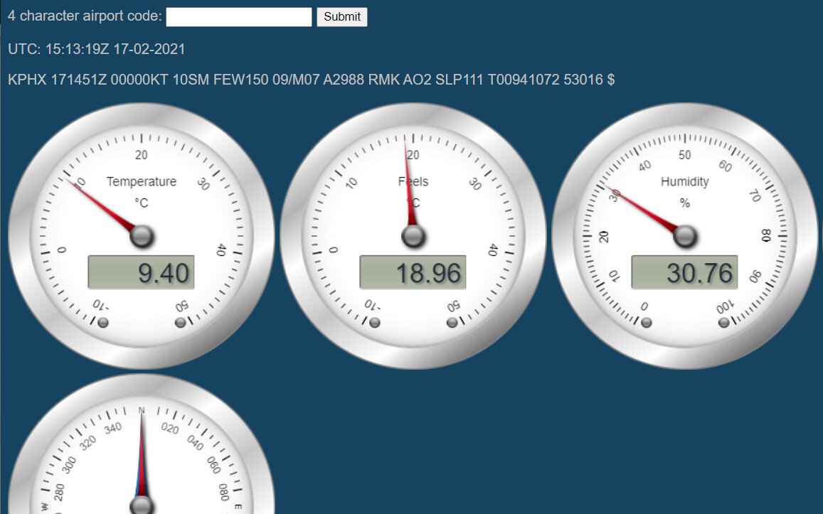

Just trying to add a way to change the airport code and have it refresh the page on the click of a submit button.
Have spent around 5 hours trying to make it work via two options.
  1. Add a text entry box and submit button in the HTML code that is served up, but I cant find a way to reload the page with the new msg.payload inserted back into the start of the flow.
  2. Found some examples in the forums here where people have launched to URLs with buttons in the dashboard, but I can't figure out how to reverse engineer that code to be a text box or how to have the Node-RED dashboard launch the websocket rather than a web URL in a new tab.
I think I like option 1 the best, it seems really intuitive and clean UI, just type in the new code, click the button and the METAR is loaded and the dials update.
But how do you reload the websocket with the new code from within the websocket page?

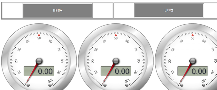

I looked into this a bit further. Here is a suggestion that works when I test it. It gives you some ideas how to use websockets and change airport codes, in this case with fixed buttons on the top row
Here is the template code you can try in the "HTML Page" node. In addition, change the connection line directly to the "Call METAR Service" node and add a debug node (to check what is coming out as websocket messages) like in the picture below

        <td><div style="text-align:center"><button id="p19" class="off" onMouseDown="doSend('KPHX', this)" style="background-color:grey; color:white; height:60px; width:280px">&nbsp;KPHX&nbsp;</button></div></td>
        <td><div style="text-align:center"><button id="p21" class="off" onMouseDown="doSend('LOWI', this)" style="background-color:grey; color:white; height:60px; width:280px">&nbsp;LOWI&nbsp;</button></div></td>
        <td><div style="text-align:center"><button id="p20" class="off" onMouseDown="doSend('EDDH', this)" style="background-color:grey; color:white; height:60px; width:280px">&nbsp;EDDH&nbsp;</button></div></td>

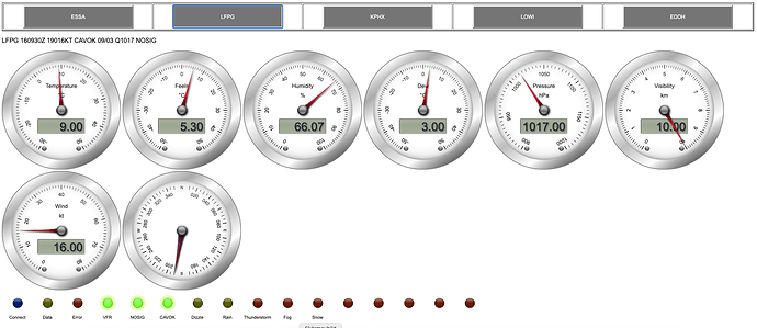

@krambriw Thanks so much for taking the time to look at my question.
I can see where you have added the buttons in the HTML.
I can also see the function in the <script> that you added (the doSend).
Unfortunately your flow does not work.
The buttons and dials load up Ok.
But the HTTP get node is never called. The buttons do nothing.
The debug node simply shows an 'empty' on first connect.
No data is ever loaded.
That's strange since it works fine here?? And, obvioulsy, you did try to click on the buttons? And nothing came out to the debug?
Was this the complete flow I posted?
Ok, very interesting that it works for you.
It should not make a difference, but I am running Node-RED v1.2.7 on a Windows 10 PC.
I imported the whole flow exactly from this thread.

I made the change and cant see any difference in the webpage, the debug tab or anywhere for that matter.
Buttons and gauges still load.
Pressing buttons does nothing (You see them depress - a black highlight around them).
Should actually be kind of blue

Same results with that simple function.
Nothing.
Buttons and gauges load, but no data shows up, I don't see the METAR string under the buttons, nothing in the debug tab.

The webpage now looks like this;
I added UTC time so the user could see how old the current METAR is.
The flow looks like this;
And here is the flow as it currently stands. I think I have everything working the way that makes sense. Already had some thumbs up from a few users, so its been a worthwhile little exercise.
