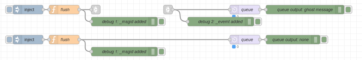

Got a weird error which I tracked down to queue node. Not sure what is going on.
NR version: 4.1.1.
Node: 22
When sending flush control message, it also outputs the control message from the queue (with flush prop removed).
The message I define with flush includes _msgid and _event properties. But I didn't set this in the function node it originated from. I used this function node to return flush message back to queue: return { flush: 1 };.
Digged some more, and it seems to be affected by link in/out nodes. When function node use return {reset: 1}, it automagically adds _msgid prop. When it goes through link node, _event prop is added.
Seems like queue node can handle msg with reset, _msgid and _event. But when I try the same with flush, _msgid and _event, it treats it as both a flush control message and a new message. This removes the flush prop, but keeps _msgid and _event. Here is a simplified example:

Seems like queue node has a bug that treats control messages with _event prop as both control message and a new message for the queue?
Temp fix for me is to always add function node before queue node with this code:
const isControlMessage = msg.flush != null || msg.reset != null;
const hasEvent = msg._event != null;
if (isControlMessage && hasEvent) {
  delete msg._event;
