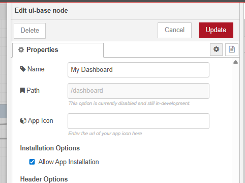

The App icon can be changed (and it can be disabled)?
