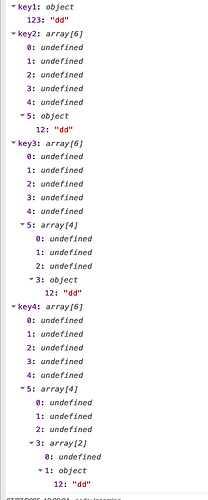

One of the nice things about assignment is that arrays and objects are automagically created, so if I do the following assignments, everything gets created:
The following happens:
My question is why is the last twelve interpreted as a keyname for an object and not as an array of twelve elements, as the keys before it are?
So key2.5.12 creates a key key2 that becomes an array of 5 with the fifth element being an object with a key '12' with a value of 'dd'. I would have expected key2 to be an array with the five elements with the fifth value being an array of 12 elements with the twelfth element being 'dd'.
From the examples, it seems that the rule is that the last value is always a key-name for an object.
My question is therefore: is this assumption correct and is it a desired feature or a bug?
If it's a bug, it probably won't be fixed because of backward compatibility ...

Feels like a bug to me.
Well I am confused because I cannot see how an array comes into being. I would have thought that all of these should be Objects. I am sure that someone will explain why that is not the case :grin:
Yes, normally, you would use brackets to create arrays - have you tried that? Dot notation would normally create objects.

An object can be addressed using array syntax or dot-notation. So what happens when I do obj.key[1]? Is key an array or an object?
The number dot-notation, i.e, key.1.2.3 seems to be an Node-RED extension of that logic: if objects can be addressed using array notation, why can't arrays be addressed using object dot-notation? key here might be an array then.

brackets and dots are interchangeable in NR - which is actually a good thing (unlike in NodeJS) since it provides consistency but leads to this confusion!

I agree, this is something inside Node-RED, not standard. Node-RED has a function that allows more flexible access for things like gets and sets and I'm guessing that is what this feature uses.
However, I still think the original reported results constitute a bug in Node-RED because the results are inconsistent.
