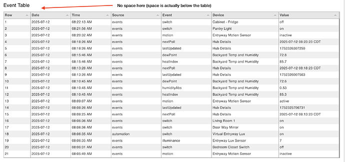

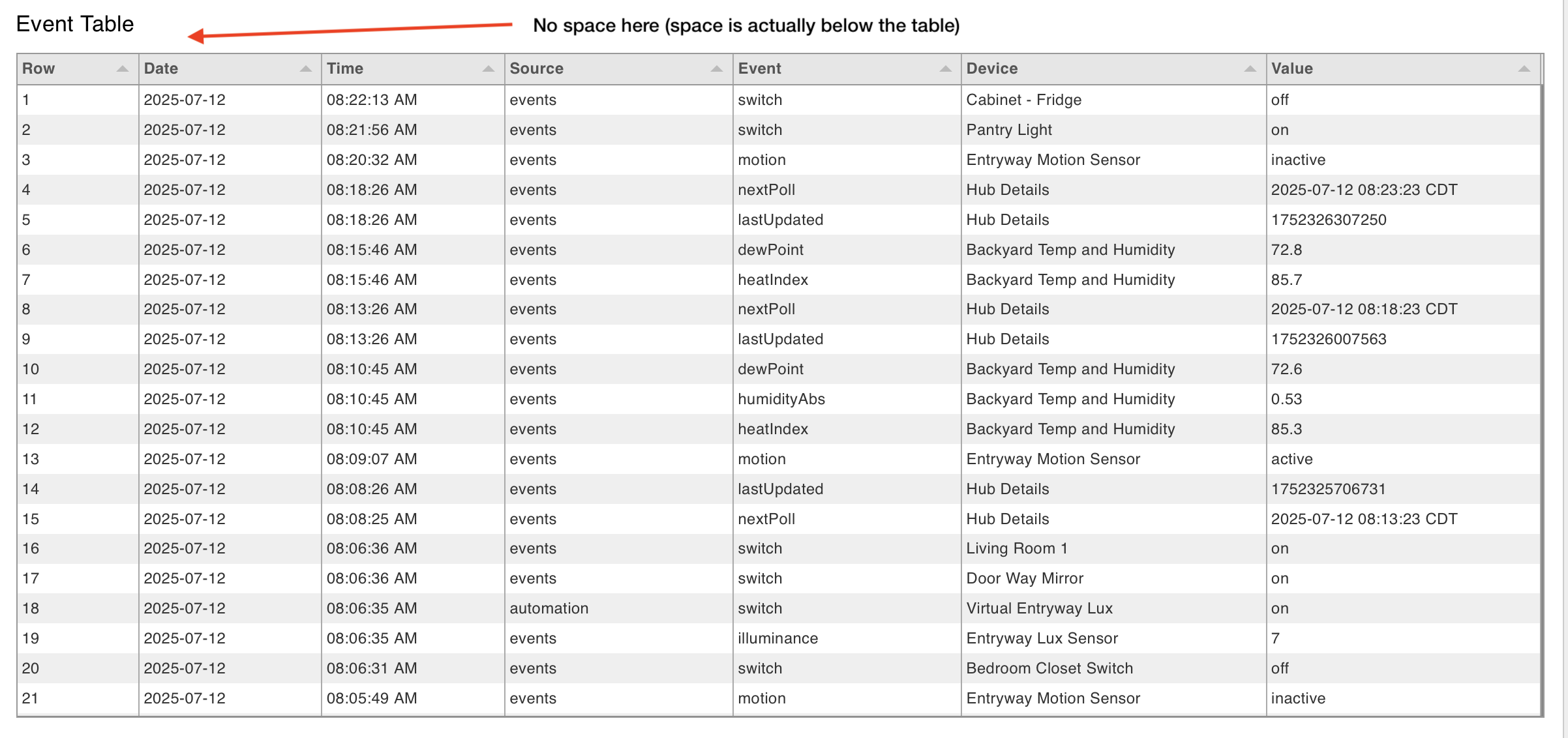

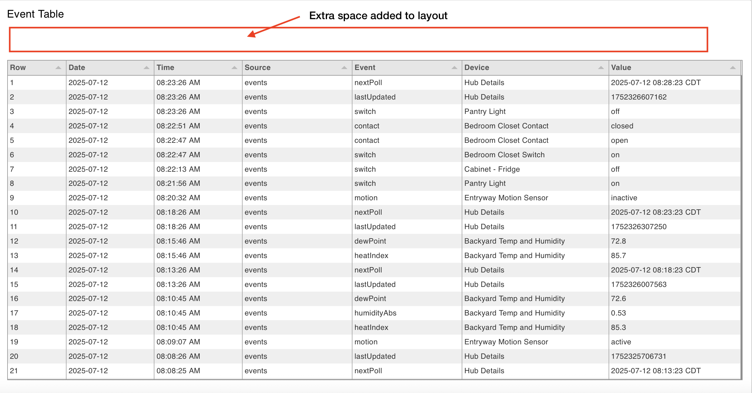

Is ui_template supposed to take up real estate on a DB2 page? If so, how can I "hide" that space.
Below is an example:
ui_template above a ui-tabulator node
ui_template positioned beiow a ui-tabulator node

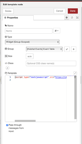

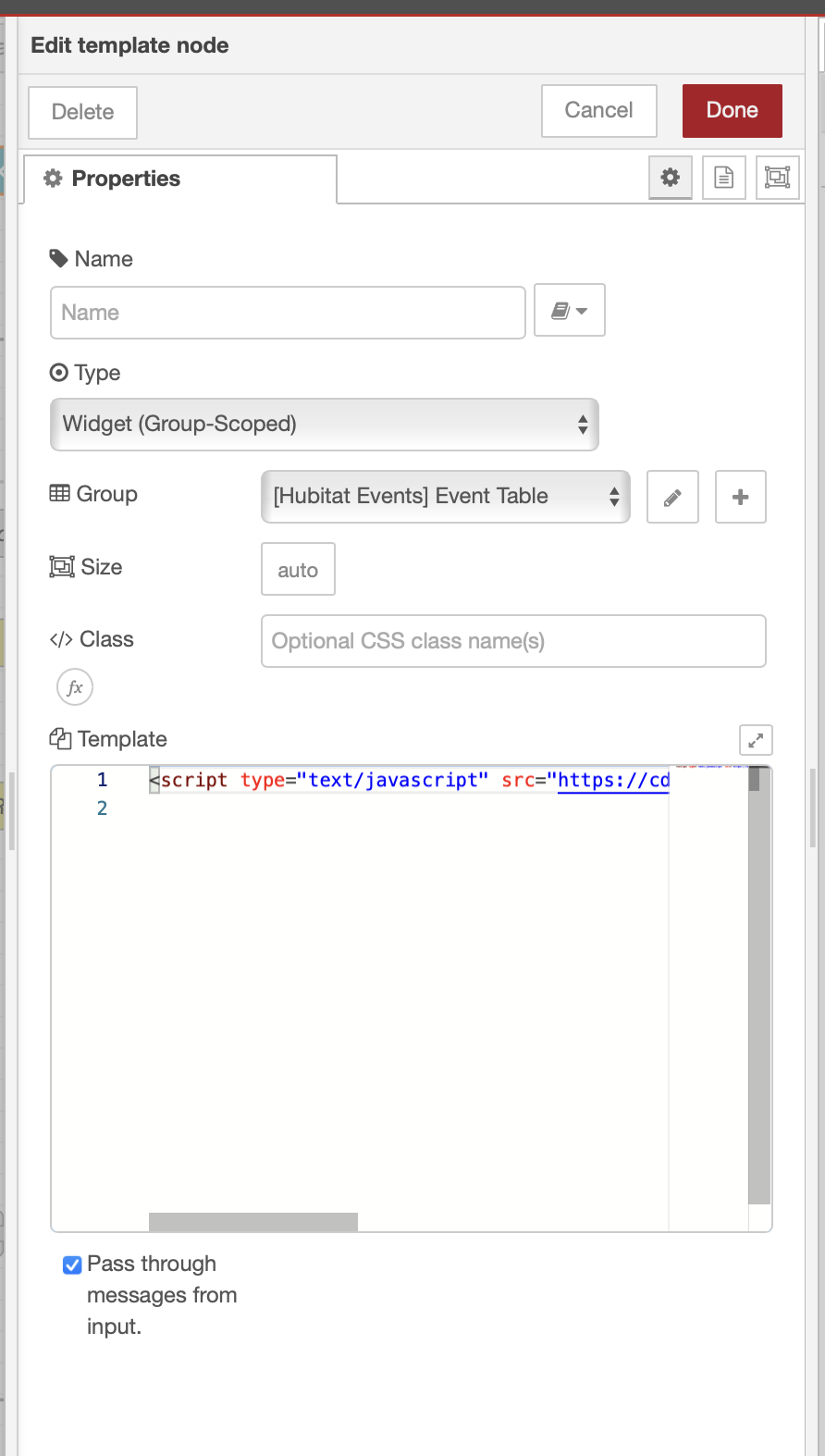

ui_template node config

Just because you didn't enter any elements, doesn't mean they don't still get a container. Try changing the type option (change the scope)
You can also add CSS to target the widgets parent group and hide it like that.
Try adding d-none to the class name field.
d-none
Thanks @Steve-Mcl. I changed the scope to "Widget (ui scoped)" and that seems to work. Since it basically loads the Luxon date library (required by ui-tabulator) making it global will work for tables on different pages.
