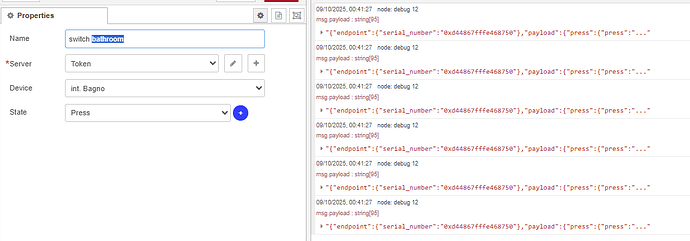

These are my first projects with node red.
I try to use node red to control sonoff devices (zigbee).
In this simple project if I make a single press on button I see the same row of event repeated more then once. I would ask if this is correct.
Tks in advance.
Lucio

If you need advice on fixing it please tell us about your system, the hardware involved, any non-standard nodes you have installed and at least a screen capture of your flow.
I have install nodered on IHost Docker. In Node red I have installed in addition to the standar objects, node-red-contrib-alexa-remote2-v2, node-red-contrib-ewelink-cube and node-red-contrib-time-of-day

What type is the switch bathroom node?

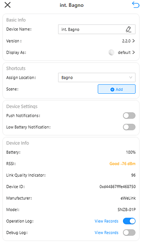

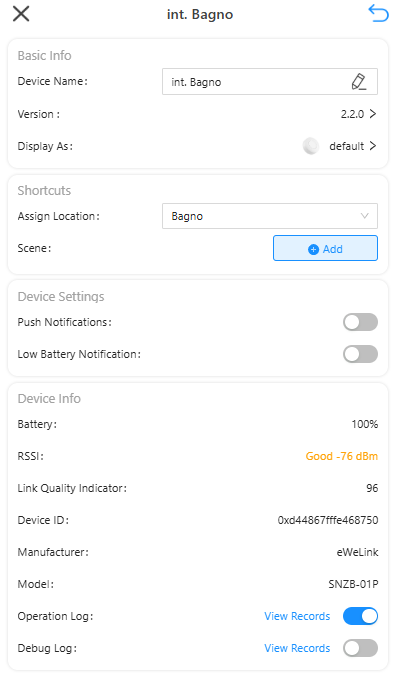

Hi,
these are informations of my device.

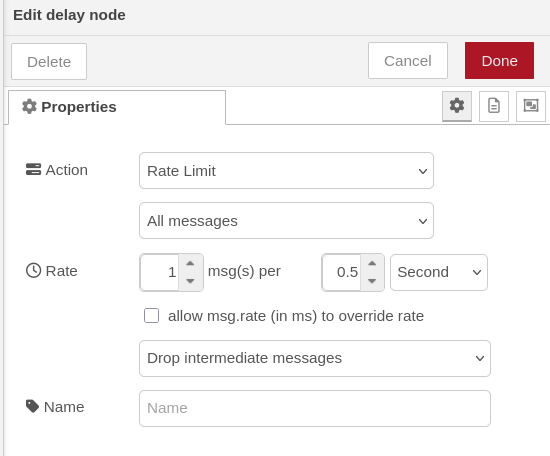

Anyway, if it does not work on zigbee level, you can still deal with it in node-red.
Just add a delay-node to the output of your switch node, configured like this
You can try and optimize the rate to your needs. Usually, 0.5 s should be a reasonable starting point.
