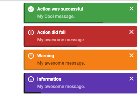

i want styling color and transparent background body and title color according to type of notification error, info,warn ....etc
error -> red
info -> green
warning -> orange
