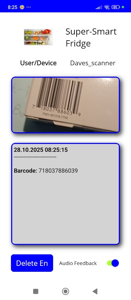

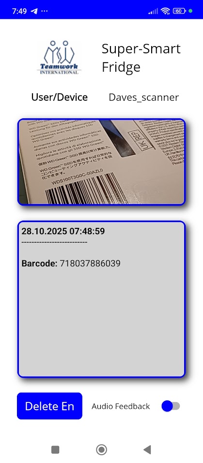

Although I've been helping Marcus with the testing (so I have a bit of a head start) - here are a couple of quick and easy things you can do to customise 'Barred'.
  1. Change the colour scheme
  2. Replace the brilliant 'barred' logo that Marcus created with your very own
  3. Change the 'Department' name to match your needs
  4. Give your scanner a more personal name
Here's an example for my 'Super-Smart Fridge' project (that I'm just starting).
Changed the logo for a view inside a fridge - NOT my fridge.
