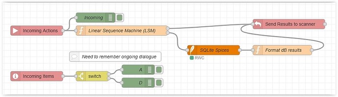

simply using a retained context variable should be more than sufficient.

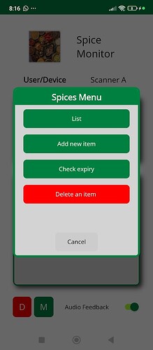

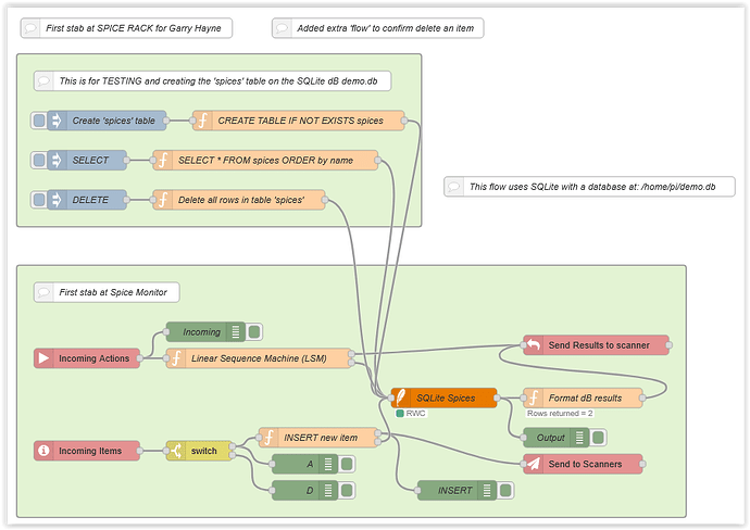

Just finished building my 'Spice Monitor' - all seems to work for @ghayne and myself.
[{"id":"spices_flow","type":"tab","label":"Spice Tracker (BARRED)","disabled":false,"info":""},{"id":"70360db4e5317c10","type":"group","z":"spices_flow","name":"","style":{"fill":"#e3f3d3","label":true},"nodes":["6164d849e91285a1","b2ca26bd9363230f","33d6018d69053bfa","398bbdb5714fcbf1","a1dab0ec604a7010","585a6d354058f3ac","876a3389a414240f"],"x":34,"y":119,"w":612,"h":262},{"id":"8955cf2843bd4469","type":"group","z":"spices_flow","name":"","style":{"fill":"#e3f3d3","label":true},"nodes":["sqlite_node","debug_out","a5f931c68b82a703","cad5db41fc8a40f9","1f01515d56b50e5a","15ae5f0567797614","3022635ec3ba0ad4","083a74ebdc9372e0","0e215495b8dcee17","a33316d9b35d7d78","016c14abdb7c8e7d","6e1546f86e0e0477","c3cfd5458e5ac253","f2b82b8ff60eb8f0","4e6e60955798706e"],"x":34,"y":439,"w":1012,"h":382},{"id":"sqlite_node","type":"sqlite","z":"spices_flow","g":"8955cf2843bd4469","mydb":"sqlite_config","sqlquery":"msg.topic","sql":"","name":"SQLite Spices","x":680,"y":640,"wires":[["6e1546f86e0e0477","debug_out"]]},{"id":"debug_out","type":"debug","z":"spices_flow","g":"8955cf2843bd4469","name":"Output","active":true,"tosidebar":true,"console":false,"tostatus":false,"complete":"true","targetType":"full","statusVal":"","statusType":"auto","x":850,"y":700,"wires":[]},{"id":"6164d849e91285a1","type":"function","z":"spices_flow","g":"70360db4e5317c10","name":"SELECT * FROM spices ORDER by name","func":"msg.topic = `SELECT * FROM spices ORDER BY name`;\n\nreturn msg;","outputs":1,"timeout":0,"noerr":0,"initialize":"","finalize":"","libs":[],"x":410,"y":280,"wires":[["sqlite_node"]]},{"id":"b2ca26bd9363230f","type":"inject","z":"spices_flow","g":"70360db4e5317c10","name":"SELECT","props":[{"p":"payload"}],"repeat":"","crontab":"","once":false,"onceDelay":0.1,"topic":"","payload":"1","payloadType":"num","x":140,"y":280,"wires":[["6164d849e91285a1"]]},{"id":"a5f931c68b82a703","type":"barred-action","z":"spices_flow","g":"8955cf2843bd4469","name":"Incoming Actions","stack":"5eb95b3f58db0bdd","x":140,"y":580,"wires":[["cad5db41fc8a40f9","016c14abdb7c8e7d"]]},{"id":"cad5db41fc8a40f9","type":"debug","z":"spices_flow","g":"8955cf2843bd4469","name":"Incoming","active":true,"tosidebar":true,"console":false,"tostatus":false,"complete":"payload","targetType":"msg","statusVal":"","statusType":"auto","x":320,"y":540,"wires":[]},{"id":"1f01515d56b50e5a","type":"barred-result","z":"spices_flow","g":"8955cf2843bd4469","name":"Send Results to scanner","defaultStatus":"OK","x":910,"y":560,"wires":[[]]},{"id":"15ae5f0567797614","type":"barred-item","z":"spices_flow","g":"8955cf2843bd4469","name":"Incoming Items","stack":"5eb95b3f58db0bdd","x":140,"y":720,"wires":[["3022635ec3ba0ad4"]]},{"id":"3022635ec3ba0ad4","type":"switch","z":"spices_flow","g":"8955cf2843bd4469","name":"","property":"menu_option","propertyType":"flow","rules":[{"t":"eq","v":"A","vt":"str"},{"t":"eq","v":"D","vt":"str"}],"checkall":"true","repair":false,"outputs":2,"x":310,"y":720,"wires":[["083a74ebdc9372e0","c3cfd5458e5ac253"],["0e215495b8dcee17"]]},{"id":"083a74ebdc9372e0","type":"debug","z":"spices_flow","g":"8955cf2843bd4469","name":"A","active":true,"tosidebar":true,"console":false,"tostatus":false,"complete":"payload","targetType":"msg","statusVal":"","statusType":"auto","x":470,"y":740,"wires":[]},{"id":"0e215495b8dcee17","type":"debug","z":"spices_flow","g":"8955cf2843bd4469","name":"D","active":true,"tosidebar":true,"console":false,"tostatus":false,"complete":"payload","targetType":"msg","statusVal":"","statusType":"auto","x":470,"y":780,"wires":[]},{"id":"a33316d9b35d7d78","type":"comment","z":"spices_flow","g":"8955cf2843bd4469","name":"First stab at Spice Monitor","info":"","x":170,"y":480,"wires":[]},{"id":"fc068410fbc9e879","type":"comment","z":"spices_flow","name":"First stab at SPICE RACK for Garry Hayne","info":"","x":200,"y":80,"wires":[]},{"id":"016c14abdb7c8e7d","type":"function","z":"spices_flow","g":"8955cf2843bd4469","name":"Linear Sequence Machine (LSM)","func":"flow.set(\"menu_option\", msg.payload.action.name);\n\nif (msg.payload.action.name == 'DEFAULT') {\n msg.status = 'MENU' // Menu Trigger\n msg.topic = 'Spices Menu' // Menu Title\n msg.payload = {\n 'List': { action: 'L', scan: false },\n 'Add new item': { action: 'A', scan: true },\n 'Check expiry': { action: 'C', scan: false },\n 'Delete an item ': { action: 'D', destructive: true, scan: true }\n }\n return [msg, null]\n}\n\n\nelse if (msg.payload.action.name == \"L\") {\n msg.topic = `SELECT * FROM spices ORDER BY name`;\n return [null, msg]\n}\n\nelse if (msg.payload.action.name == \"A\") {\n const Barcode = msg.payload.barcode.barcode;\n\n msg.status = 'INFO'\n msg.payload = {\n Name: 'string',\n Quantity: 'string',\n Expiry_date: 'date',\n Barcode: Barcode\n }\n return [msg, null];\n\n}\n\nelse if (msg.payload.action.name == \"C\") {\n msg.topic = \"SELECT * FROM spices WHERE expiry <= date('now', '+7 days') ORDER BY expiry\";\n return [null, msg];\n}\n\nelse if (msg.payload.action.name == \"D\") {\n\n flow.set(\"barcode\", msg.payload.barcode.barcode);\n\n msg.status = 'MENU' \n msg.topic = 'Delete barcode ?' \n msg.payload = {\n 'Yes': { action: 'Y', scan: false },\n 'No': { action: 'N', scan: false }\n }\n return [msg, null];\n\n}\n\nelse if (msg.payload.action.name == \"N\") {\n msg.payload = \"OK - action ignored\";\n return [msg, null];\n}\n\nelse if (msg.payload.action.name == \"Y\") {\n const barcode = flow.get(\"barcode\");\n msg.topic = `DELETE FROM spices WHERE barcode='${barcode}'`;\n return [null, msg];\n}\n","outputs":2,"timeout":0,"noerr":0,"initialize":"","finalize":"","libs":[],"x":400,"y":580,"wires":[["1f01515d56b50e5a"],["sqlite_node"]],"outputLabels":["send_result","sqlite"]},{"id":"6e1546f86e0e0477","type":"function","z":"spices_flow","g":"8955cf2843bd4469","name":"Format dB results","func":"// Get the length of the results array from the MySQL query\n\nlet sql = msg.topic;\n\n// Make sure msg.topic exists\nif (sql && sql.toUpperCase().includes(\"DELETE\")) {\n // Extract barcode from SQL string\n let match = sql.match(/barcode\\s*=\\s*'(\\d+)'/i);\n\n if (match) {\n let barcode = match[1]; // e.g. \"88888\"\n msg.payload = `Item with barcode ${barcode}\\nhas been deleted.`;\n } else {\n msg.payload = \"Item deleted (barcode not found).\";\n }\n return msg;\n}\n\nelse {\n\n let length = msg.payload.length;\n\n node.status({ text: \"Rows returned = \" + length });\n\n let action = flow.get(\"menu_option\");\n\n let ap_info = \"\"\n\n if (action == \"L\") {\n\n ap_info = \"*** Spice Rack inventory ***\\r\\n\\r\\n\";\n\n if (length == 0) {\n ap_info += \"Spice Rack appears to be empty\"\n }\n\n // Construct main body of the message\n for (let row = 0; row < length; row++) {\n ap_info += \"Name: \" + msg.payload[row].name + \"\\r\\n\";\n ap_info += \"Barcode: \" + msg.payload[row].barcode + \"\\r\\n\";\n ap_info += \"Quantity: \" + msg.payload[row].quantity + \"\\r\\n\";\n ap_info += \"Expiry date: \" + msg.payload[row].expiry + \"\\r\\n\\r\\n\";\n }\n\n msg.payload = ap_info;\n return msg;\n }\n\n else if (action == \"C\") {\n ap_info = \"*** Items expiring soon ***\\r\\n\\r\\n\";\n\n if (length == 0) {\n ap_info += \"Nothing expiring soon\"\n }\n\n // Construct main body of the message\n for (let row = 0; row < length; row++) {\n ap_info += \"Name: \" + msg.payload[row].name + \"\\r\\n\";\n ap_info += \"Barcode: \" + msg.payload[row].barcode + \"\\r\\n\";\n ap_info += \"Quantity: \" + msg.payload[row].quantity + \"\\r\\n\";\n ap_info += \"Expiry date: \" + msg.payload[row].expiry + \"\\r\\n\\r\\n\";\n }\n\n msg.payload = ap_info;\n return msg;\n\n }\n}","outputs":1,"timeout":0,"noerr":0,"initialize":"","finalize":"","libs":[],"x":890,"y":640,"wires":[["1f01515d56b50e5a"]]},{"id":"c3cfd5458e5ac253","type":"function","z":"spices_flow","g":"8955cf2843bd4469","name":"INSERT new item","func":"let item = msg.payload.item;\n\n// Prepare SQL query for output 2\nlet sqlMsg = {\n topic: `INSERT INTO spices (name, quantity, expiry, barcode)\n VALUES ('${item.Name}', '${item.Quantity}', date(${item.Expiry_date / 1000}, 'unixepoch'), '${item.Barcode}')`\n};\n\n// Prepare confirmation message for output 1\nlet payloadMsg = {\n payload: `The item ${item.Name}\\nwith barcode ${item.Barcode}\\nhas been stored.`\n};\n\n// Return messages in the order of outputs\nreturn [payloadMsg, sqlMsg];\n","outputs":2,"timeout":0,"noerr":0,"initialize":"","finalize":"","libs":[],"x":490,"y":700,"wires":[["f2b82b8ff60eb8f0","4e6e60955798706e"],["sqlite_node"]]},{"id":"33d6018d69053bfa","type":"function","z":"spices_flow","g":"70360db4e5317c10","name":"Delete all rows in table 'spices'","func":"msg.topic = `DELETE FROM spices`;\n\nreturn msg;","outputs":1,"timeout":0,"noerr":0,"initialize":"","finalize":"","libs":[],"x":370,"y":340,"wires":[["sqlite_node"]]},{"id":"398bbdb5714fcbf1","type":"inject","z":"spices_flow","g":"70360db4e5317c10","name":"DELETE","props":[{"p":"payload"}],"repeat":"","crontab":"","once":false,"onceDelay":0.1,"topic":"","payload":"1","payloadType":"num","x":140,"y":340,"wires":[["33d6018d69053bfa"]]},{"id":"f2b82b8ff60eb8f0","type":"debug","z":"spices_flow","g":"8955cf2843bd4469","name":"INSERT","active":true,"tosidebar":true,"console":false,"tostatus":false,"complete":"true","targetType":"full","statusVal":"","statusType":"auto","x":700,"y":780,"wires":[]},{"id":"a1dab0ec604a7010","type":"comment","z":"spices_flow","g":"70360db4e5317c10","name":"This is for TESTING and creating the 'spices' table on the SQLite dB demo.db","info":"","x":330,"y":160,"wires":[]},{"id":"4e6e60955798706e","type":"barred-send-item","z":"spices_flow","g":"8955cf2843bd4469","name":"Send to Scanners","stack":"5eb95b3f58db0bdd","x":890,"y":740,"wires":[[]]},{"id":"adf9f60103303bea","type":"comment","z":"spices_flow","name":"Added extra 'flow' to confirm delete an item","info":"","x":580,"y":80,"wires":[]},{"id":"876a3389a414240f","type":"function","z":"spices_flow","g":"70360db4e5317c10","name":"CREATE TABLE IF NOT EXISTS spices","func":"msg.topic = `CREATE TABLE IF NOT EXISTS spices (\n id INTEGER PRIMARY KEY AUTOINCREMENT,\n name TEXT,\n quantity TEXT,\n expiry DATE,\n barcode TEXT\n)`;\nreturn msg;","outputs":1,"timeout":0,"noerr":0,"initialize":"","finalize":"","libs":[],"x":460,"y":220,"wires":[["sqlite_node"]]},{"id":"585a6d354058f3ac","type":"inject","z":"spices_flow","g":"70360db4e5317c10","name":"Create 'spices' table","props":[{"p":"payload"}],"repeat":"","crontab":"","once":false,"onceDelay":0.1,"topic":"","payload":"1","payloadType":"num","x":170,"y":220,"wires":[["876a3389a414240f"]]},{"id":"b69bb2bee3a0ddc9","type":"comment","z":"spices_flow","name":"This flow uses SQLite with a database at: /home/pi/demo.db","info":"","x":900,"y":320,"wires":[]},{"id":"sqlite_config","type":"sqlitedb","db":"/home/pi/demo.db","mode":"RWC"},{"id":"5eb95b3f58db0bdd","type":"barred-config","name":"BARRED Config","department":"Spice Monitor","color":"#008040","rate":"3000","rtimeout":"1000","scanners":{"646af871-ccf6-476f-b781-283beb1cd691":{"index":0,"scannerLabel":"Scanner A","scannerId":"646af871-ccf6-476f-b781-283beb1cd691"}},"host":"192.168.1.152","port":"50031"}]
The flow uses SQLite so the database is located locally on your Raspberry Pi.

Nice addition of the "Create Table" Inject node!
