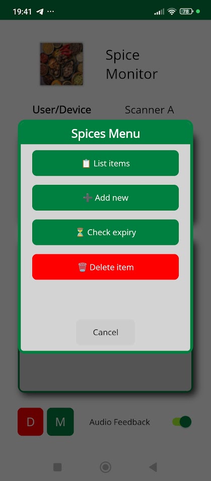

FYI - just a reminder that emojis can be used in the menu structure and text responses.
Just replace lines 7 to 14 with this code in the 'LSM' function node.
    msg.payload = {
        '๐Ÿ“‹ List items': { action: 'L' },
        'โž• Add new': { action: 'A', scan: true },
        'โณ Check expiry': { action: 'C' },
        '๐Ÿ—‘๏ธ Delete item': { action: 'D', destructive: true, scan: true }
    return [msg, null]

I knew emojis were possible in the terminal - but having them in the menu is a new one to me :nerd_face:

They are just characters at the end of the day. So as long as whatever you are using supports UTF-8, you should be good. I use them now extensively in JavaScript and the web.

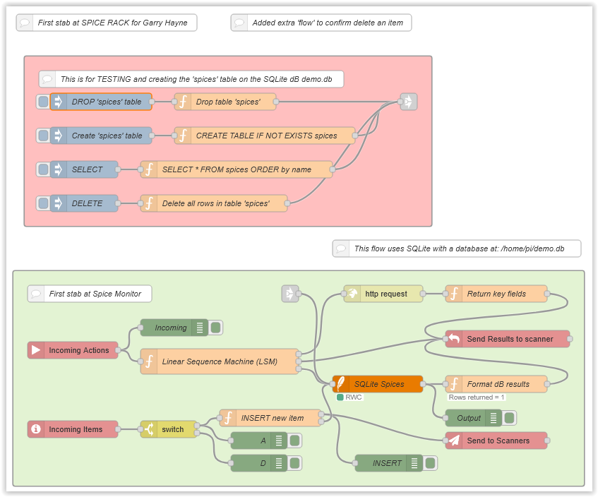

Just had a go at incorporating the API food-stuff look-up. See notes at bottom of post.
[{"id":"spices_flow","type":"tab","label":"Spice Tracker (BARRED)","disabled":false,"info":""},{"id":"70360db4e5317c10","type":"group","z":"spices_flow","name":"","style":{"fill":"#ffbfbf","label":true},"nodes":["6164d849e91285a1","b2ca26bd9363230f","33d6018d69053bfa","398bbdb5714fcbf1","a1dab0ec604a7010","585a6d354058f3ac","876a3389a414240f","2222073ace8856d8","91dd11d16aca6da2","b0e3ee6cb75aeba9"],"x":54,"y":139,"w":722,"h":302},{"id":"8955cf2843bd4469","type":"group","z":"spices_flow","name":"","style":{"fill":"#e3f3d3","label":true},"nodes":["sqlite_node","debug_out","a5f931c68b82a703","cad5db41fc8a40f9","1f01515d56b50e5a","15ae5f0567797614","3022635ec3ba0ad4","083a74ebdc9372e0","0e215495b8dcee17","a33316d9b35d7d78","6e1546f86e0e0477","c3cfd5458e5ac253","f2b82b8ff60eb8f0","4e6e60955798706e","ec6ee194f932168b","0afe54bf0b9fcbda","d9dc8ff22b702143","7be8c66a940200d9"],"x":34,"y":519,"w":1012,"h":382},{"id":"sqlite_node","type":"sqlite","z":"spices_flow","g":"8955cf2843bd4469","mydb":"sqlite_config","sqlquery":"msg.topic","sql":"","name":"SQLite Spices","x":680,"y":720,"wires":[["6e1546f86e0e0477","debug_out"]]},{"id":"debug_out","type":"debug","z":"spices_flow","g":"8955cf2843bd4469","name":"Output","active":true,"tosidebar":true,"console":false,"tostatus":false,"complete":"true","targetType":"full","statusVal":"","statusType":"auto","x":850,"y":780,"wires":[]},{"id":"6164d849e91285a1","type":"function","z":"spices_flow","g":"70360db4e5317c10","name":"SELECT * FROM spices ORDER by name","func":"msg.topic = `SELECT * FROM spices ORDER BY name`;\n\nreturn msg;","outputs":1,"timeout":0,"noerr":0,"initialize":"","finalize":"","libs":[],"x":430,"y":340,"wires":[["b0e3ee6cb75aeba9"]]},{"id":"b2ca26bd9363230f","type":"inject","z":"spices_flow","g":"70360db4e5317c10","name":"SELECT","props":[{"p":"payload"}],"repeat":"","crontab":"","once":false,"onceDelay":0.1,"topic":"","payload":"1","payloadType":"num","x":160,"y":340,"wires":[["6164d849e91285a1"]]},{"id":"a5f931c68b82a703","type":"barred-action","z":"spices_flow","g":"8955cf2843bd4469","name":"Incoming Actions","stack":"5eb95b3f58db0bdd","x":140,"y":660,"wires":[["cad5db41fc8a40f9","ec6ee194f932168b"]]},{"id":"cad5db41fc8a40f9","type":"debug","z":"spices_flow","g":"8955cf2843bd4469","name":"Incoming","active":true,"tosidebar":true,"console":false,"tostatus":false,"complete":"payload","targetType":"msg","statusVal":"","statusType":"auto","x":320,"y":620,"wires":[]},{"id":"1f01515d56b50e5a","type":"barred-result","z":"spices_flow","g":"8955cf2843bd4469","name":"Send Results to scanner","defaultStatus":"OK","x":910,"y":640,"wires":[[]]},{"id":"15ae5f0567797614","type":"barred-item","z":"spices_flow","g":"8955cf2843bd4469","name":"Incoming Items","stack":"5eb95b3f58db0bdd","x":140,"y":800,"wires":[["3022635ec3ba0ad4"]]},{"id":"3022635ec3ba0ad4","type":"switch","z":"spices_flow","g":"8955cf2843bd4469","name":"","property":"menu_option","propertyType":"flow","rules":[{"t":"eq","v":"A","vt":"str"},{"t":"eq","v":"D","vt":"str"}],"checkall":"true","repair":false,"outputs":2,"x":310,"y":800,"wires":[["083a74ebdc9372e0","c3cfd5458e5ac253"],["0e215495b8dcee17"]]},{"id":"083a74ebdc9372e0","type":"debug","z":"spices_flow","g":"8955cf2843bd4469","name":"A","active":true,"tosidebar":true,"console":false,"tostatus":false,"complete":"payload","targetType":"msg","statusVal":"","statusType":"auto","x":470,"y":820,"wires":[]},{"id":"0e215495b8dcee17","type":"debug","z":"spices_flow","g":"8955cf2843bd4469","name":"D","active":true,"tosidebar":true,"console":false,"tostatus":false,"complete":"payload","targetType":"msg","statusVal":"","statusType":"auto","x":470,"y":860,"wires":[]},{"id":"a33316d9b35d7d78","type":"comment","z":"spices_flow","g":"8955cf2843bd4469","name":"First stab at Spice Monitor","info":"","x":170,"y":560,"wires":[]},{"id":"fc068410fbc9e879","type":"comment","z":"spices_flow","name":"First stab at SPICE RACK for Garry Hayne","info":"","x":200,"y":80,"wires":[]},{"id":"6e1546f86e0e0477","type":"function","z":"spices_flow","g":"8955cf2843bd4469","name":"Format dB results","func":"// Get the length of the results array from the MySQL query\n\nlet sql = msg.topic;\n\n// Make sure msg.topic exists\nif (sql && sql.toUpperCase().includes(\"DELETE\")) {\n    // Extract barcode from SQL string\n    let match = sql.match(/barcode\\s*=\\s*'(\\d+)'/i);\n\n    if (match) {\n        let barcode = match[1];  // e.g. \"88888\"\n        msg.payload = `Item with barcode ${barcode}\\nhas been deleted.`;\n    } else {\n        msg.payload = \"Item deleted (barcode not found).\";\n    }\n    return msg;\n}\n\nelse {\n\n    let length = msg.payload.length;\n\n    node.status({ text: \"Rows returned = \" + length });\n\n    let action = flow.get(\"menu_option\");\n\n    let ap_info = \"\"\n\n    if (action == \"L\") {\n\n        ap_info = \"*** Spice Rack inventory ***\\r\\n\\r\\n\";\n\n        if (length == 0) {\n            ap_info += \"Spice Rack appears to be empty\"\n        }\n\n        // Construct main body of the message\n        for (let row = 0; row < length; row++) {\n            ap_info += \"Name: \" + msg.payload[row].name + \"\\r\\n\";\n            ap_info += \"Barcode: \" + msg.payload[row].barcode + \"\\r\\n\";\n            ap_info += \"Brand: \" + msg.payload[row].brand + \"\\r\\n\";\n            ap_info += \"Quantity: \" + msg.payload[row].quantity + \"\\r\\n\";\n            ap_info += \"Expiry date: \" + msg.payload[row].expiry + \"\\r\\n\\r\\n\";\n        }\n\n        msg.payload = ap_info;\n        return msg;\n    }\n\n    else if (action == \"C\") {\n        ap_info = \"*** Items expiring soon ***\\r\\n\\r\\n\";\n\n        if (length == 0) {\n            ap_info += \"Nothing expiring soon\"\n        }\n\n        // Construct main body of the message\n        for (let row = 0; row < length; row++) {\n            ap_info += \"Name: \" + msg.payload[row].name + \"\\r\\n\";\n            ap_info += \"Barcode: \" + msg.payload[row].barcode + \"\\r\\n\";\n            ap_info += \"Brand: \" + msg.payload[row].brand + \"\\r\\n\";\n            ap_info += \"Quantity: \" + msg.payload[row].quantity + \"\\r\\n\";\n            ap_info += \"Expiry date: \" + msg.payload[row].expiry + \"\\r\\n\\r\\n\";\n        }\n\n        msg.payload = ap_info;\n        return msg;\n\n    }\n}","outputs":1,"timeout":0,"noerr":0,"initialize":"","finalize":"","libs":[],"x":890,"y":720,"wires":[["1f01515d56b50e5a"]]},{"id":"c3cfd5458e5ac253","type":"function","z":"spices_flow","g":"8955cf2843bd4469","name":"INSERT new item","func":"let item = msg.payload.item;\n\n// Prepare SQL query for output 2\nlet sqlMsg = {\n    topic: `INSERT INTO spices (name, brand, quantity, expiry, barcode)\n            VALUES ('${item.Name}', '${item.Brand}', '${item.Quantity}', date(${item.Expiry_date / 1000}, 'unixepoch'), '${item.Barcode}')`\n};\n\n// Prepare confirmation message for output 1\nlet payloadMsg = {\n    payload: `The item ${item.Name}\\nwith barcode ${item.Barcode}\\nhas been stored.`\n};\n\n// Return messages in the order of outputs\nreturn [payloadMsg, sqlMsg];\n","outputs":2,"timeout":0,"noerr":0,"initialize":"","finalize":"","libs":[],"x":490,"y":780,"wires":[["f2b82b8ff60eb8f0","4e6e60955798706e"],["sqlite_node"]]},{"id":"33d6018d69053bfa","type":"function","z":"spices_flow","g":"70360db4e5317c10","name":"Delete all rows in table 'spices'","func":"msg.topic = `DELETE FROM spices`;\n\nreturn msg;","outputs":1,"timeout":0,"noerr":0,"initialize":"","finalize":"","libs":[],"x":390,"y":400,"wires":[["b0e3ee6cb75aeba9"]]},{"id":"398bbdb5714fcbf1","type":"inject","z":"spices_flow","g":"70360db4e5317c10","name":"DELETE","props":[{"p":"payload"}],"repeat":"","crontab":"","once":false,"onceDelay":0.1,"topic":"","payload":"1","payloadType":"num","x":160,"y":400,"wires":[["33d6018d69053bfa"]]},{"id":"f2b82b8ff60eb8f0","type":"debug","z":"spices_flow","g":"8955cf2843bd4469","name":"INSERT","active":true,"tosidebar":true,"console":false,"tostatus":false,"complete":"true","targetType":"full","statusVal":"","statusType":"auto","x":700,"y":860,"wires":[]},{"id":"a1dab0ec604a7010","type":"comment","z":"spices_flow","g":"70360db4e5317c10","name":"This is for TESTING and creating the 'spices' table on the SQLite dB demo.db","info":"","x":350,"y":180,"wires":[]},{"id":"4e6e60955798706e","type":"barred-send-item","z":"spices_flow","g":"8955cf2843bd4469","name":"Send to Scanners","stack":"5eb95b3f58db0bdd","x":890,"y":820,"wires":[[]]},{"id":"adf9f60103303bea","type":"comment","z":"spices_flow","name":"Added extra 'flow' to confirm delete an item","info":"","x":580,"y":80,"wires":[]},{"id":"876a3389a414240f","type":"function","z":"spices_flow","g":"70360db4e5317c10","name":"CREATE TABLE IF NOT EXISTS spices","func":"msg.topic = `\nCREATE TABLE spices (\n    id INTEGER PRIMARY KEY AUTOINCREMENT,\n    name TEXT,\n    brand TEXT,\n    quantity TEXT,\n    expiry DATE,\n    barcode TEXT\n);\n`;\nreturn msg;\n","outputs":1,"timeout":0,"noerr":0,"initialize":"","finalize":"","libs":[],"x":480,"y":280,"wires":[["b0e3ee6cb75aeba9"]]},{"id":"585a6d354058f3ac","type":"inject","z":"spices_flow","g":"70360db4e5317c10","name":"Create 'spices' table","props":[{"p":"payload"}],"repeat":"","crontab":"","once":false,"onceDelay":0.1,"topic":"","payload":"1","payloadType":"num","x":190,"y":280,"wires":[["876a3389a414240f"]]},{"id":"b69bb2bee3a0ddc9","type":"comment","z":"spices_flow","name":"This flow uses SQLite with a database at: /home/pi/demo.db","info":"","x":820,"y":480,"wires":[]},{"id":"ec6ee194f932168b","type":"function","z":"spices_flow","g":"8955cf2843bd4469","name":"Linear Sequence Machine (LSM)","func":"flow.set(\"menu_option\", msg.payload.action.name);\n\nif (msg.payload.action.name == 'DEFAULT') {\n    msg.status = 'MENU'                             // Menu Trigger\n    msg.topic = 'Spices Menu'\n\n    msg.payload = {\n        '๐Ÿ“‹ List items': { action: 'L' },\n        'โž• Add new': { action: 'A', scan: true },\n        'โณ Check expiry': { action: 'C' },\n        '๐Ÿ—‘๏ธ Delete item': { action: 'D', destructive: true, scan: true }\n    };\n    return [null, msg, null]\n}\n\n\nelse if (msg.payload.action.name == \"L\") {\n    msg.topic = `SELECT * FROM spices ORDER BY name`;\n    return [null, null, msg]\n}\n\nelse if (msg.payload.action.name == \"A\") {\n    msg.barcode = msg.payload.barcode.barcode;\n    msg.url = `https://world.openfoodfacts.org/api/v0/product/${msg.payload.barcode.barcode}.json`\n    return [msg, null, null];\n}\n\nelse if (msg.payload.action.name == \"C\") {\n    msg.topic = \"SELECT * FROM spices WHERE expiry <= date('now', '+7 days') ORDER BY expiry\";\n    return [null, null, msg];\n}\n\nelse if (msg.payload.action.name == \"D\") {\n\n    flow.set(\"barcode\", msg.payload.barcode.barcode);\n\n    msg.status = 'MENU'\n    msg.topic = 'Delete barcode ?'\n    msg.payload = {\n        'Yes': { action: 'Y', scan: false },\n        'No': { action: 'N', scan: false }\n    }\n    return [null, msg, null];\n\n}\n\nelse if (msg.payload.action.name == \"N\") {\n    msg.payload = \"OK - action ignored\";\n    return [null, msg, null];\n}\n\nelse if (msg.payload.action.name == \"Y\") {\n    const barcode = flow.get(\"barcode\");\n    msg.topic = `DELETE FROM spices WHERE barcode='${barcode}'`;\n    return [null, null, msg];\n}\n","outputs":3,"timeout":0,"noerr":0,"initialize":"","finalize":"","libs":[],"x":400,"y":680,"wires":[["0afe54bf0b9fcbda"],["1f01515d56b50e5a"],["sqlite_node"]],"outputLabels":["A option","send_result","sqlite"]},{"id":"7be8c66a940200d9","type":"function","z":"spices_flow","g":"8955cf2843bd4469","name":"Return key fields","func":"const p = msg.payload.product\n\nmsg.status = \"INFO\";\nmsg.payload = {\n    Name: p.product_name_en,\n    Barcode: msg.barcode,\n    Brand: p.brands,\n    Quantity: p.quantity,\n    Expiry_date: 'date'\n};\nreturn msg;","outputs":1,"timeout":0,"noerr":0,"initialize":"","finalize":"","libs":[],"x":890,"y":560,"wires":[["1f01515d56b50e5a"]]},{"id":"0afe54bf0b9fcbda","type":"http request","z":"spices_flow","g":"8955cf2843bd4469","name":"","method":"GET","ret":"obj","paytoqs":"ignore","url":"","tls":"","persist":false,"proxy":"","insecureHTTPParser":false,"authType":"","senderr":false,"headers":[],"x":690,"y":560,"wires":[["7be8c66a940200d9"]]},{"id":"91dd11d16aca6da2","type":"function","z":"spices_flow","g":"70360db4e5317c10","name":"Drop table 'spices'","func":"// Drop the table\nmsg.topic = `DROP TABLE IF EXISTS spices;`;\nreturn msg;\n\n","outputs":1,"timeout":0,"noerr":0,"initialize":"","finalize":"","libs":[],"x":410,"y":220,"wires":[["b0e3ee6cb75aeba9"]]},{"id":"2222073ace8856d8","type":"inject","z":"spices_flow","g":"70360db4e5317c10","name":"","props":[{"p":"payload"},{"p":"topic","vt":"str"}],"repeat":"","crontab":"","once":false,"onceDelay":0.1,"topic":"","payload":"","payloadType":"date","x":160,"y":220,"wires":[["91dd11d16aca6da2"]]},{"id":"b0e3ee6cb75aeba9","type":"link out","z":"spices_flow","g":"70360db4e5317c10","name":"OUT_testing","mode":"link","links":["d9dc8ff22b702143"],"x":735,"y":220,"wires":[]},{"id":"d9dc8ff22b702143","type":"link in","z":"spices_flow","g":"8955cf2843bd4469","name":"IN_sqlite","links":["b0e3ee6cb75aeba9"],"x":525,"y":560,"wires":[["sqlite_node"]]},{"id":"sqlite_config","type":"sqlitedb","db":"/home/pi/demo.db","mode":"RWC"},{"id":"5eb95b3f58db0bdd","type":"barred-config","name":"BARRED Config","department":"Spice Monitor","color":"#008040","rate":"3000","rtimeout":"1000","scanners":{"646af871-ccf6-476f-b781-283beb1cd691":{"index":0,"scannerLabel":"Scanner A","scannerId":"646af871-ccf6-476f-b781-283beb1cd691"}},"host":"192.168.1.152","port":"50031"}]
Notes:
1: After scanning the item all you need to do is use the calendar to select the 'expiry date'
2: The table structure needs to be changed to include 'brand' column
Use 'DROP' and then 'Create' in the pink coloured part of the flow to alter the table..
3: You will need to replace MY scanner's credentials with YOURS in the config area.
Discovered that some items returned by the food-products API do not have a quantity attribute.
Made some changes to the 'Return key fields' function node to deal with this situation. I also capture barcode in msg.barcode in the LSM (so have attached latest flow below).

Here's the latest complete 'flow' (as of 14:00hrs on 14/Nov/2025)...
