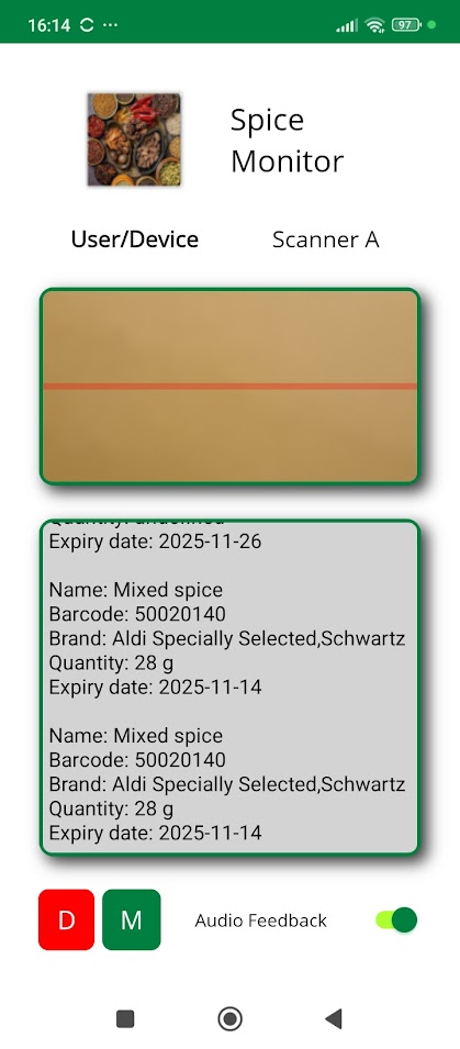

I've got around it by checking if 'quantity' is blank or empty - and if it is - then offer the user the opportunity to enter the weight. A sort of quick fix.
I'm editing the product now, if you can share a pic with all the details :wink:
Just says 28g on the glass jar. Once you have updated the product I'll try re-scanning.
The returned object says.. "Aldi Specially Selected, Schwartz' although on the glass jar there is no reference to Aldi. Strange.
28g it is when you scan now, easy to edit on their web page.
OMG - just re-scanned the glass jar and if by magic it now says... 28g - woopppeee

Since it is definitely Schwartz, I removed Aldi tag.
I don't think it would take long to correct any items that I have in my Kitchen.
Oh - so that means... I have to delete it using 'Spice Rack Monitor' and re-scan it. More work.
EDIT: Just performed the above steps and now get...
