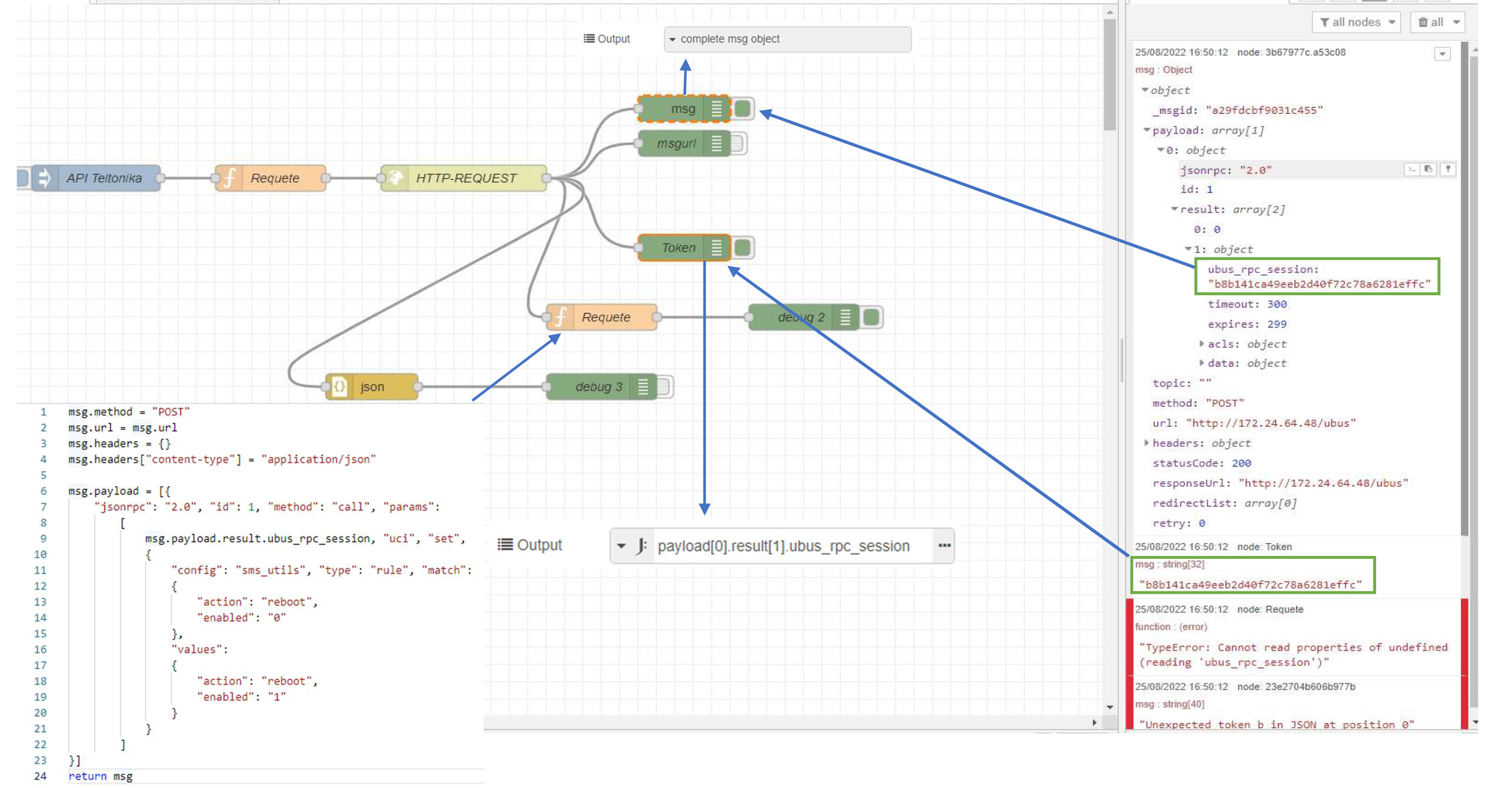

Remove the quotes, as they make the property a string.
I took the value I used from your debug node, please show us the contents of msg debug copy the value using the debug side bar and paste here, so we can see exactly where your session value is.
A picture is worth a thousand words ...
I hope my request is understandable.
Sorry !
It 's OK !!!

No text is better as we can then copy and edit and paste with ease.
According to your debug
msg.payload[0].result[1].ubus_rpc_session
should work without quotes.
