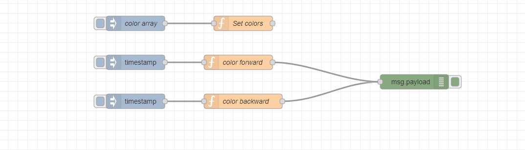

I am trying to make a flow to go back and forward in an array of colors, and for the most part it works
But when I go from pressing "forward" to "backward", the first time I press backward it goes forward in the array and then starts going backwards, same happens the other way around, when going from backward to forward.
Could anyone tell me why this happens and how to fix it ?

Like this?

Exactly like that, thanks a lot for the super fast reply!
I'm trying to understand why my example didn't work, is this the reason? or is there more to it ?
No, usage of var was not your issue here.
In your case, you were collecting the color value BEFORE adjusting the index position
Ofcouse, Thanks again for the help, node status in the debug node was a nice trick too :slight_smile:
