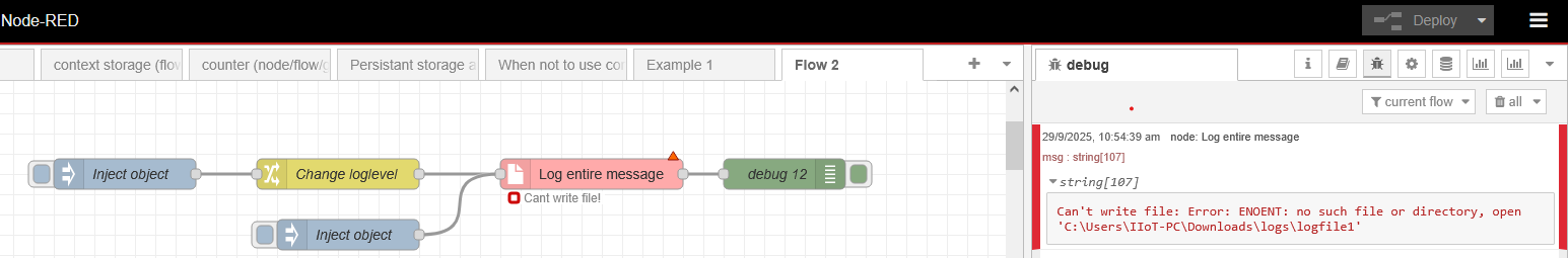

My aim is to implement auto-logger with auto rotation feature in my flow. And flogger node seems can serve my purpose. However, I cannot seem to make flogger node work. I tested on both windows and Linux (PI). But I'm getting same error on both:"Can't write file: No such file or directory"

I'm attaching flogger configuration and error image for reference:

  1. Does that directory exist?
  2. Try changing to regular slashes (C:/Users/etc)
  3. Does the account running Node-RED have access to that directory?
@Steve-Mcl Regular slash is the solution.
For windows: (forward slash is required) [eg] => C:/Users/IIoT-PC/Downloads
For linux: (forward slash followed by path is required [eg] => /home/dell

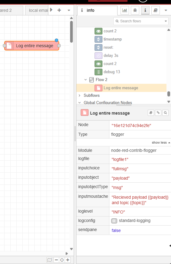

However, I'm getting RED_TRIANGLE at the top of flogger node even though node is working fine. Hovering over the node shows "Invalid properties expression: zero length".
I read the node-info and there is no such property that is required to be provided as input to the flogger node.
  1. What version of Node-RED are you using
  2. What version of NodeJS are you using?
  3. Show us what the info panel has for the node and its config node...
    chrome_yCKOmuObhh
Also, try adding a new flogger and a new flogger config - do you get the issue triangle on the new ones?
Like you said, just copy-pasted the same node and connected the same input/output the new one does the JOB. But out of curiosity. What happened earlier?

Either you imported a "badly configured node" from a flow somewhere online or at some point, you have altered the Log option and left an invalid value
chrome_Pqtq4BICCa
Default flogger node imported example's "Log entire message" node is the only one shows that RED-triangle in my case. Just copying and pasting it and reattaching the I/O does the JOB.
Thanks for the help
But @Steve-Mcl, I would like to point out something.It is better to create new node as mentioned by you [with new configuration [delete the older one]]. otherwise, making any changes to the copied node(i was doing earlier), creates the TRIANGLE.
