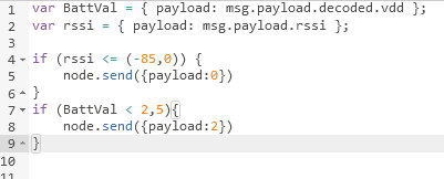

function
this is the function, i am just using this for an example so the final code will be different.
For BattVal i am getting the "2" as an output, but for the rssi this does not work.
Please post code rather than images, it is much easier to help then.
So what is wrong with:
if ( msg.payload.rssi <= -85 ) {
    // ... do something ...
The rssi you've shown isn't an object, it is a number as shown in the debug output.
