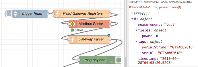

Which appears in the debug window to return the same string as follows:
However, the InfluxDB does not see them the same way because trying to use the hard coded string works fine but using the one passed from the buffer.toString gives the following error when used in queries:
found GTYA002018, expected identifier, string, number, bool
Which interestingly when pasted into some text windows and previewed I have witnessed an an extra diamond shaped character I haven't seen before preceding the expected string. This may be the clue as to where the issue is coming from although it's not appearing in this window.
