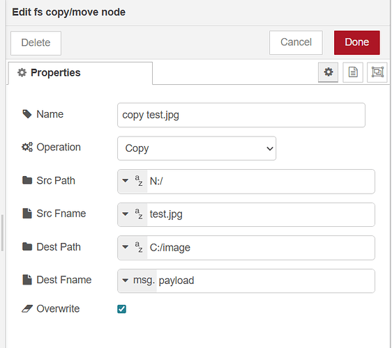

Hello, I'm new to Node-Red and I'm looking for help on how to move a file from an N:\ drive to C:\image folder. However I get and error TypeError: The "path" argument must be of type string. Received undefined.

Use a debug node parallel to the file node to show the path string and post it here.

When using Windows paths, the \ character can be an issue as it is an "escape" character in JavaScript strings. Windows always lets you use / instead though so try that to see if it helps. Some of the core nodes already allow for this and work with \ but contributed nodes may not.
Coping “N:\test.jpg” failed: ENOENT: no such file or directory, copyfile 'N:\test.jpg' -> 'C:\image\2025-12-09T11:50:30.874Z'
As suggested, use forward slashes not backslashes.
Thank you for the suggestions. I changed to forward slashes in the node, but still getting the same error. However, if I change the the Dest Fname to a string it works, and copies the file to the target location.
Coping “N:\test.jpg” failed: ENOENT: no such file or directory, copyfile 'N:\test.jpg' -> 'C:\image\2025-12-09T12:41:19.338Z'
However, this works
