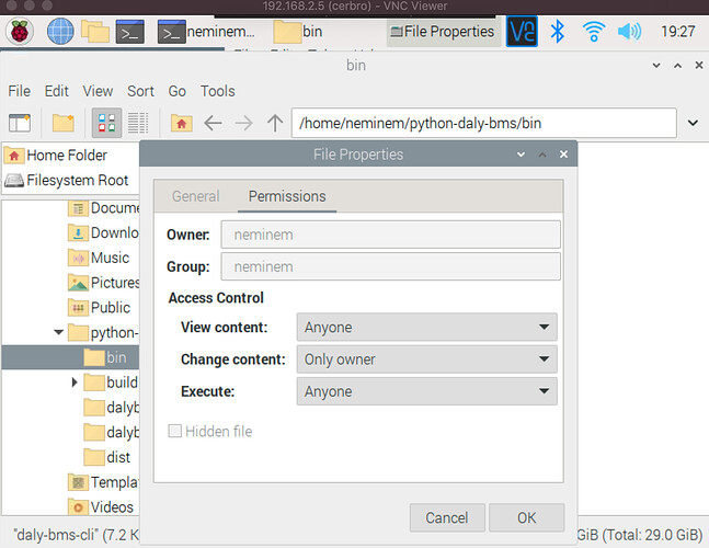

What is the full path of daly-bms-cli? Try using the full path in the exec node
Also, does the account running node-red have permission to access it?
If you put connect a debug node to the second output from Exec you will see any error message.
I tried with the full path but nothing, if I put debug node on the other two output no messages, the account who is running node red is the right one "neminem". I don't know what's wrong and if I run the command in a terminal window everything works fine and I get every data from the bms only in Node Red doesn't work...

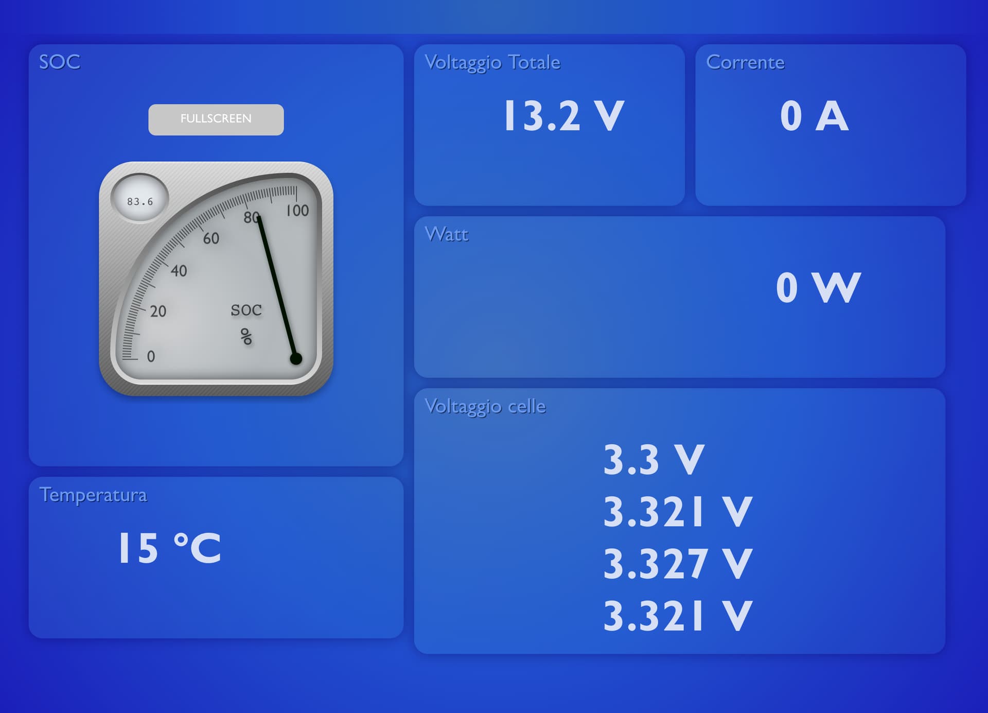

Ok thanks, despite the error it seems to work anyway...here a screenshot from my dashboard:
The only problem that I have now it's to display the voltage of the 4 cells. For example if I want to display the voltage of cell 1 I tried with this
