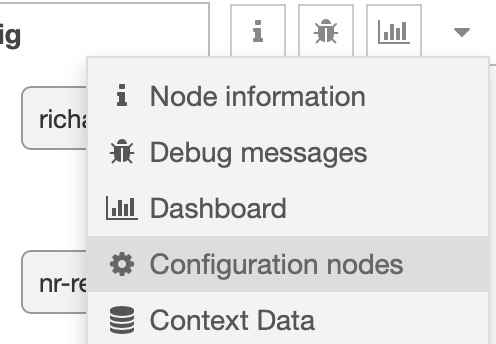

Click "configuration nodes"
You will see it disabled:
