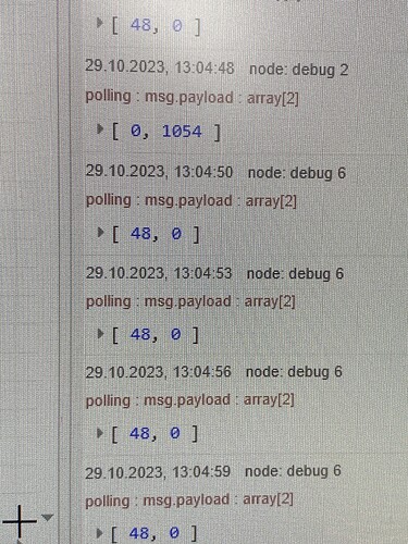

Alright well i am Form Germany so i only understood Most of it- but i try to show my Problem by Pictures -
So this is My value i am getting from the debug node
-it is 48,0
The value gets every 3seconds read out - but this shows my chart

Any way you have an array as input, you would need to move the value you require to payload.
e.g
[{"id":"3c3cf116beba1ad6","type":"inject","z":"d1395164b4eec73e","name":"","props":[{"p":"payload"},{"p":"topic","vt":"str"}],"repeat":"","crontab":"","once":false,"onceDelay":0.1,"topic":"t","payload":"[39,0]","payloadType":"json","x":150,"y":980,"wires":[["06ca833a3b9edb62","83de3c343773eeed"]]},{"id":"06ca833a3b9edb62","type":"debug","z":"d1395164b4eec73e","name":"debug 345","active":true,"tosidebar":true,"console":false,"tostatus":false,"complete":"false","statusVal":"","statusType":"auto","x":290,"y":920,"wires":[]},{"id":"83de3c343773eeed","type":"change","z":"d1395164b4eec73e","name":"","rules":[{"t":"set","p":"payload","pt":"msg","to":"payload[0]","tot":"msg"}],"action":"","property":"","from":"","to":"","reg":false,"x":280,"y":1040,"wires":[["af5548e48a0467d5","267e79ae657c4e67"]]},{"id":"af5548e48a0467d5","type":"ui_chart","z":"d1395164b4eec73e","name":"","group":"4f791fdc1745d3d9","order":2,"width":0,"height":0,"label":"chart","chartType":"line","legend":"false","xformat":"HH:mm:ss","interpolate":"linear","nodata":"","dot":false,"ymin":"","ymax":"","removeOlder":1,"removeOlderPoints":"","removeOlderUnit":"3600","cutout":0,"useOneColor":false,"useUTC":false,"colors":["#1f77b4","#aec7e8","#ff7f0e","#2ca02c","#98df8a","#d62728","#ff9896","#9467bd","#c5b0d5"],"outputs":1,"useDifferentColor":false,"className":"","x":390,"y":1080,"wires":[[]]},{"id":"267e79ae657c4e67","type":"debug","z":"d1395164b4eec73e","name":"debug 346","active":true,"tosidebar":true,"console":false,"tostatus":false,"complete":"false","statusVal":"","statusType":"auto","x":450,"y":1000,"wires":[]},{"id":"4f791fdc1745d3d9","type":"ui_group","name":"micro","tab":"c954274bbed7292e","order":1,"disp":false,"width":"18","collapse":false,"className":""},{"id":"c954274bbed7292e","type":"ui_tab","name":"Solar","icon":"dashboard","order":1,"disabled":false,"hidden":false}]
In a change node prior to chart node.
set msg. payload
to the value msg. payload[0]
An array is reresented by [ ]
