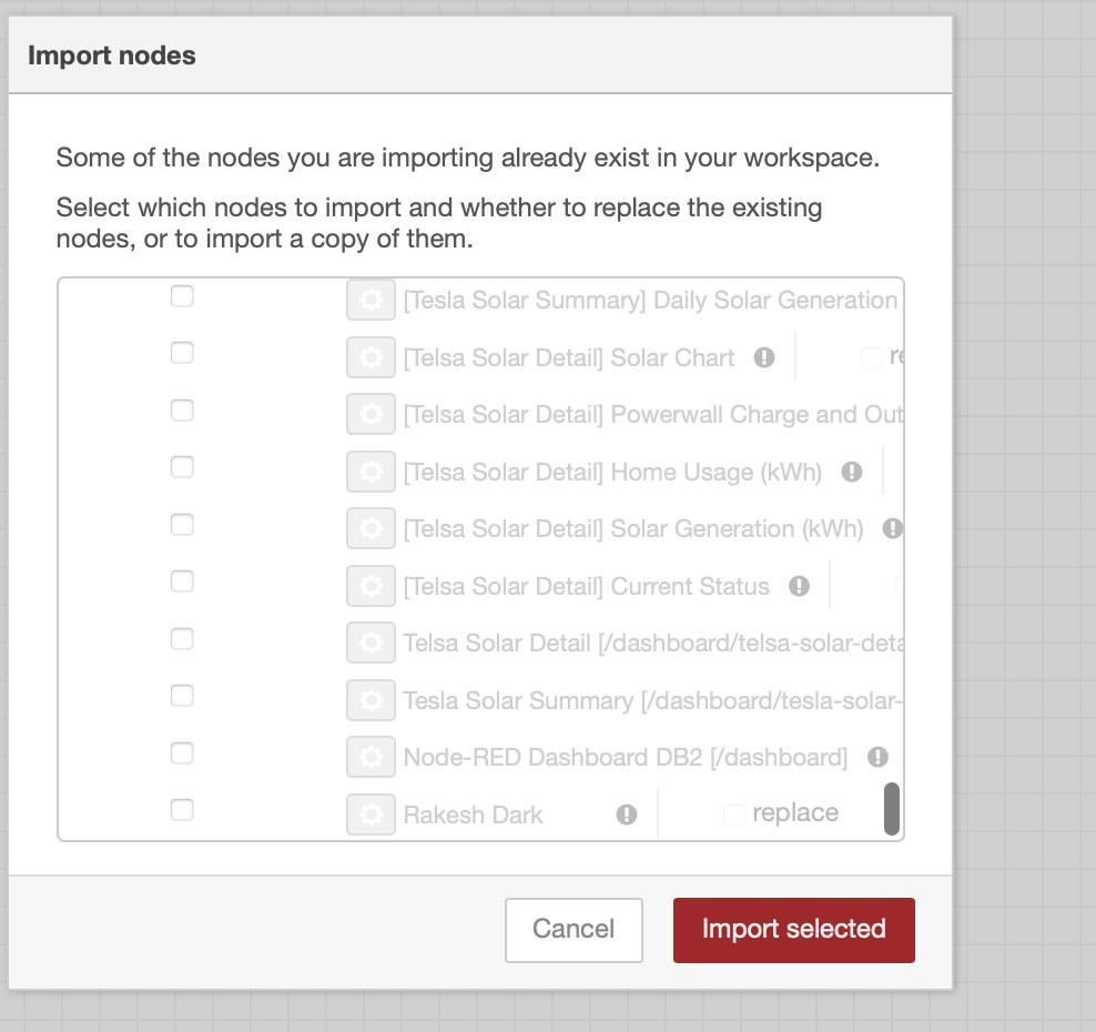

Unfortunately, it is really hard to select what to duplicate. The window cannot be resized and the icons/text are grayed out making it even harder to figure out what is what in the “config nodes” section.

Yeah - I just tried that and here is what I found.
  1. The duplicate ui-pages, ui-groups and widgets were imported but the duplicate groups were not associated with these pages (they were all associated with the original page) and the widgets had the original group name. So now the original page had duplicates of everything and the new “copied” page was empty.
  2. The duplicate ui-page had the same url as the original page (not a big deal but something something that NR will complain about when deploying)
Going through and sorting that out is almost not worth it unfortunately.
I wish what would happen is that duplicate config/nodes appended “copy” to the objects that are copied and retain the hierarchy? It would also make it simpler to find and edit the copy
