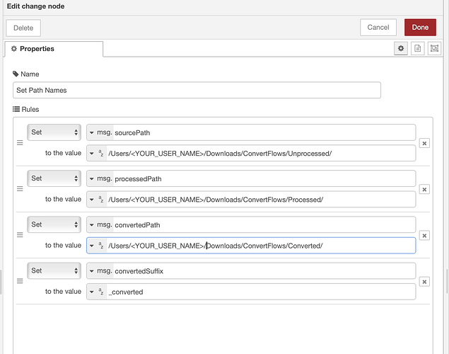

@WhiteLion - I’ve updated the flow so that it can now process multiple source files. The folder structure that I used was
Files start in “Unprocessed”. After processing, the converted files are in “Converted” and the original files are moved to “Processed”. The setup is done in a change node:
Here is the updated flow (it uses the node-red-contrib-fs-ops node for directory operations). I have tested this on a Mac and it does appear to work.
