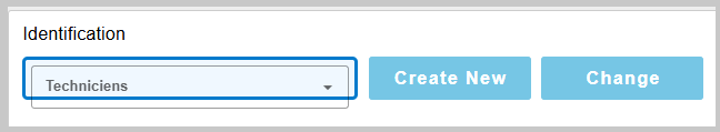

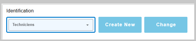

I use DB2 for my small application dashboard. I use many dropdown list for that. I also use template to tune dropdown list and help user to recongnize input field needed. Here is one of the situation I get with @flowfuse/node-red-dashboard 1.24.0
And here is the situation a get with @flowfuse/node-red-dashboard 1.26.0
Some ideas to solve this problem ?

There have been some changes to the way sizes are applied. You may have to adjust your CSS template.
Post a very simple example showing the problem if you can't sort it out.

Your border and padding are messing up the layout. If you remove those then the dropdown sits in the correct place. You will have to inspect the DOM elements and adjust your template to match the slightly changed layout in the latest dashboard version.
