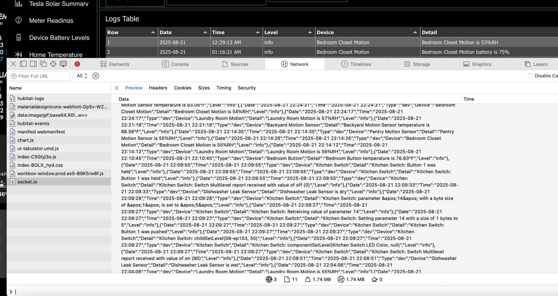

You may be able to test the msg size by looking at your browser's dev tools. Have a look at the network tab on the socket.io line marked by a 101 status code. Here is an example from my home dashboard that uses UIBUILDER:
Each msg over socket.io shows the length of the msg. It should let you fine-tune your buffer size.
I’m not seeing similar output in Safari Web Inspector. I do see the Network tab and the socket.io line but the result looks nothing like yours.
Should I be looking elsewhere? Or a different browser?
In safari you can see the socket data in the sources tab.
I would install a Chromium based browser such as Vivaldi or Brave.
