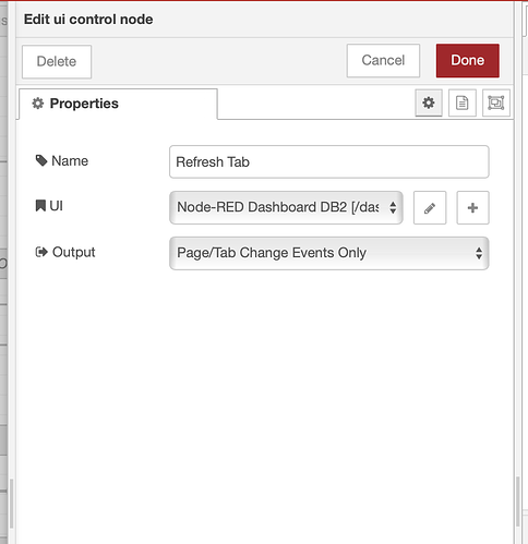

I am using ui-control to do exactly that. What have you selected in the drop down for “Output”?

Thank you @rakgupta. I had it set to “All events” but now when I check I am getting output intermittently. It seems that the tab change event is only output when there is also a connect event.
Thanks for your reply.
With the settings I have, I get the events triggered quite reliably. I use it to start the flows on each tab to pre-populate data when the user selects a particular tab/page. I do have another ui-control node that is set to “connect events only” - this is used to populate some global variables etc. that are used across all flows.
