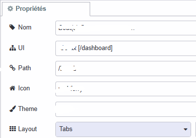

In the Layout section of ui_page, I’m using TABS.
So, for this page, I have several tabs. I have a Save button that is common to all the tabs, and I’d like to know which tab is active when the user clicks on it. Is it possible?
