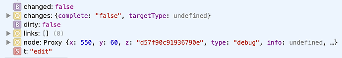

Can someone confirm this or is it just me but does a debug node cause an unnecessary change?
What happens is that I create a new debug node, save the flow, open the edit panel for the debug node, make no change, close the debug edit panel and the flow has changed or rather the deploy button tells me something changed. I save the changes and then open the edit panel for the debug node, make no change again but this time the flow isn't changed.

Related to node.complete and node.targetType changing:

I also suspected, complete & targetType - I changed them here to:
-            complete: {value:"false", required:true},
-            targetType: {value:undefined},
+            complete: {value:"payload", required:true},
+            targetType: {value:"msg"},
since that's the default ....
