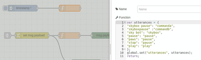

one way, no need for parsing
create a command object, that is stored in the context data.
//function to create context data need to edit settings json to make it survive reloads
var utterances = {
"skybox_pause": "command a",
"sky_bot_paws" :"command a",
"pause_skybox": "command a",
"another_1": "command b",
"another_2": "command b",
"more_1": "command c",
"more_2": "command c",
"more_3": "command c"
global.set("utterances", utterances);
return;
You can then add multiple phrases to one command. By removing the simon says from the incoming alexa phrase, you can retrieve the command for that phrase from the context data.
//function retrieve command
var incoming_phrase = "simon says skybox pause"
msg.payload = global.get("utterances." + incoming_phrase.substr(11).replace(/ /g, "_"));
output msg.payload returns "command a"

Like the idea here but its not working for me
PS _ I'm stripping off the simon says before it gets to your function node
I think we can't have spaces in the global.get line
i.e global.get("utterances." + "skybox pause")
isn't valid because of the space in "skybox pause"

Spaces are fine there.
Have you stripped the simon says correctly , i.e. have you left white space at beginning
edit/ strick that, it may not like space as i never tested with your phrases.
try Using _ in comand object keys, then replace all white space with _ , in the simon says phrase.
Well -I'm manually setting the string
and without a space it all works
So I'm thinking that spaces aren't allowed in object properties (but I'm no JS expert BTW)
My utterances def BTW
edited previous post
Obvious solution - ta :slight_smile:

Spaces are OK when accessing the properties using a string key in brackets, e.g. obj['property key']. So in this case instead of:
global.get("utterances." + "skybox pause");
you could write:
global.get("utterances")["skybox pause"];
