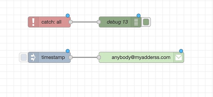

When you run the flow, does it fail right away?
add a catch node connected to a debug node (set to display the complete msg object) and see if that shows anything,

[update] I just ran using the exact credentials you show (yes I know the user iid and password are fake) and get this in return from a catch node:
Screenshot 2023-01-07 at 4.59.46 PM

Did you add a catch node like I suggested? What you posted looks like it came from a log
Thank you. Yes the text I posted is the "stack" section of the debug node connected to a "catch all" node.
Is this OK ? I have not used catch all before
