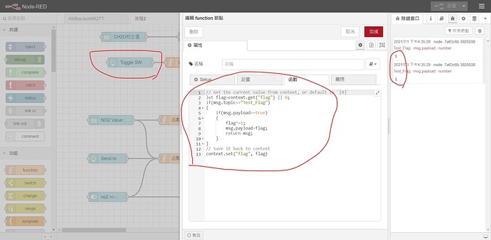

Dear dceejay :
Sorry..., Here again. Still cant be correct! at pic and below :
  1. I press Toggle SW 2 times it still send 1 to debug window.
  2. So my code where is wrong?
Thank u.
You return msg inside the if block - which means the context.set() line at the end does not get called,
Move the context.set line to just before the return msg line.
Dear knolleary :
Oh, I see, Im so so so stupid..haha.
Thank u very much.
