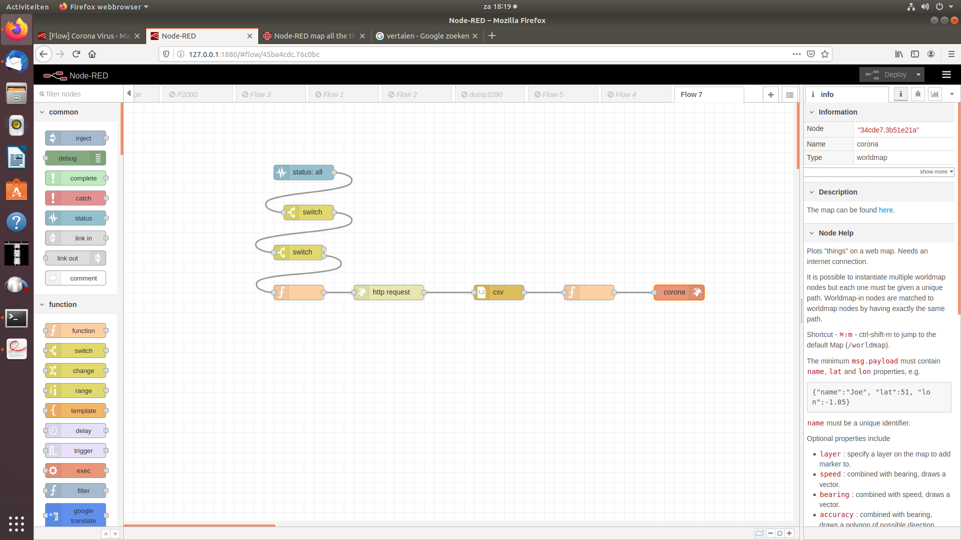

@bakman2 your flow uses an endpoint /corona which while "obvious" to those of us who have been here before - is not the default /worldmap - so can be slightly hard to find if you don't just know :slight_smile:
But the link in the info tab is pointing correctly to the corona map (?).
@edwin - you have changed the original flow, if it does not work I cannot help.
I don't understand what you mean by corona map ??
This is what i see on the right screen
Maybe this program is too complicated for me
This is what I get when I start worldmap
ik stuur je een pm.
Try putting /corona instead of /worldmap on the end of the URL (just a guess - I haven't loaded the flow)
Steve, you just beat me to suggesting putting /corona in the Dashboard view.
It works fine for me.
I need to be faster next time!!!
It works now.
I used http://127.0.0.1:1880/worldmap instead of http://127.0.0.1:1880/corona
