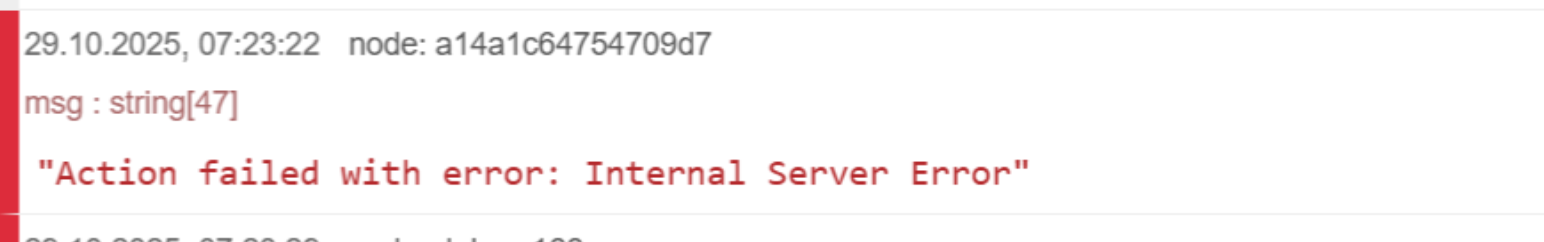

Any idea what is wrong?
what is the fritzbox-in node? it's the one failing with an internal error - hard to say what the internal error is without knowing what node that is.
Node Ids are the same:
hence it must be the fritzbox-in node causing the problem

if this dial aid is not enabled I also get this error message "Action failed with error: Internal Server Error"

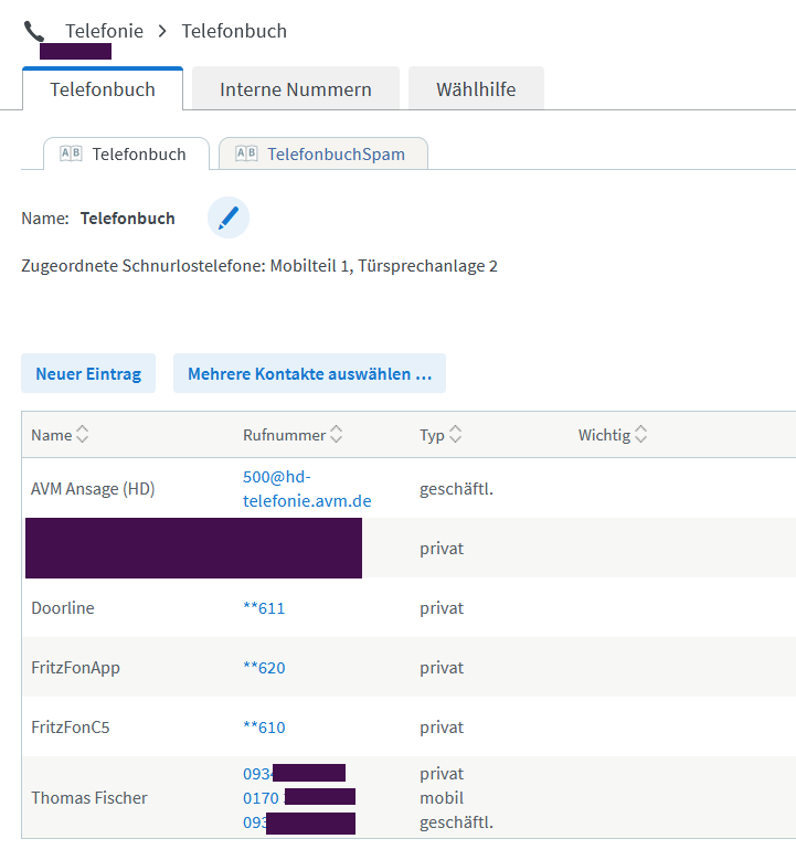

I don't know if this is necessary, but
I have my smartphone number also in the telephone book.

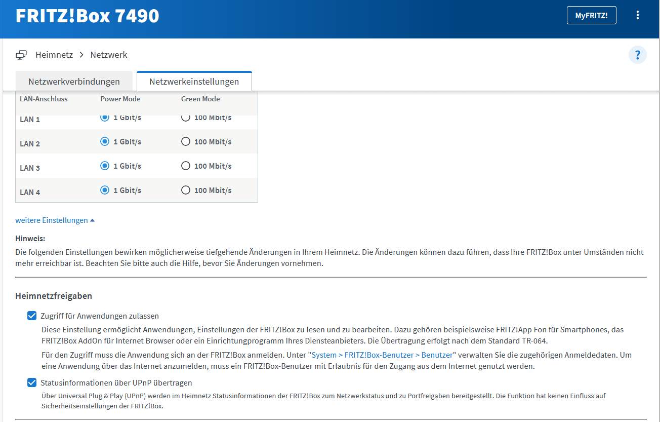

additional requirement
"noch eine Anforderung"
"Zugriff für Anwendungen zulassen" see last screenshot

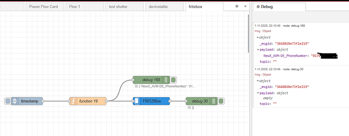

        "id": "fe5c8d627eae0bbf",
        "type": "tab",
        "label": "fritzbox",
        "disabled": false,
        "info": "",
        "env": []
        "id": "7541bd3e87f03df4",
        "type": "debug",
        "z": "fe5c8d627eae0bbf",
        "name": "debug 168",
        "active": true,
        "tosidebar": true,
        "console": false,
        "tostatus": true,
        "complete": "true",
        "targetType": "full",
        "statusVal": "payload",
        "statusType": "auto",
        "x": 950,
        "y": 260,
        "id": "18d89d3e97504c2a",
        "type": "inject",
        "props": [
                "p": "payload"
                "p": "topic",
                "vt": "str"
        "repeat": "",
        "crontab": "",
        "once": false,
        "onceDelay": 0.1,
        "topic": "",
        "payload": "",
        "payloadType": "date",
        "x": 480,
        "y": 340,
                "28acff48057ee398"
        "id": "28acff48057ee398",
        "type": "function",
        "name": "function 19",
        "func": "msg.payload = {\n    \"NewX_AVM-DE_PhoneNumber\": \"0170???????\"\n}\nreturn msg;",
        "outputs": 1,
        "timeout": 0,
        "noerr": 0,
        "initialize": "",
        "finalize": "",
        "libs": [],
        "x": 710,
        "y": 340,
                "a14a1c64754709d7",
                "7541bd3e87f03df4"
        "id": "a14a1c64754709d7",
        "type": "fritzbox-in",
        "device": "160733b6c516c7b7",
        "service": "urn:dslforum-org:service:X_VoIP:1",
        "action": "X_AVM-DE_DialNumber",
        "arguments": "{\n  \"NewX_AVM-DE_PhoneNumber\": \"value\"\n}",
        "x": 950,
        "y": 340,
                "cd41e4e60cd1a10b"
        "id": "cd41e4e60cd1a10b",
        "type": "debug",
        "name": "debug 30",
        "active": true,
        "tosidebar": true,
        "console": false,
        "tostatus": true,
        "complete": "true",
        "x": 1140,
        "y": 340,
        "id": "160733b6c516c7b7",
        "type": "fritzbox-config",
        "name": "FritzBox",
        "host": "192.168.70.99",
        "port": "49000",
        "ssl": false,
        "user": "fritz9041"
        "id": "d4617c89e87340ba",
        "type": "global-config",
        "env": [],
        "modules": {
            "node-red-contrib-fritz": "1.4.5"
Now it works!
