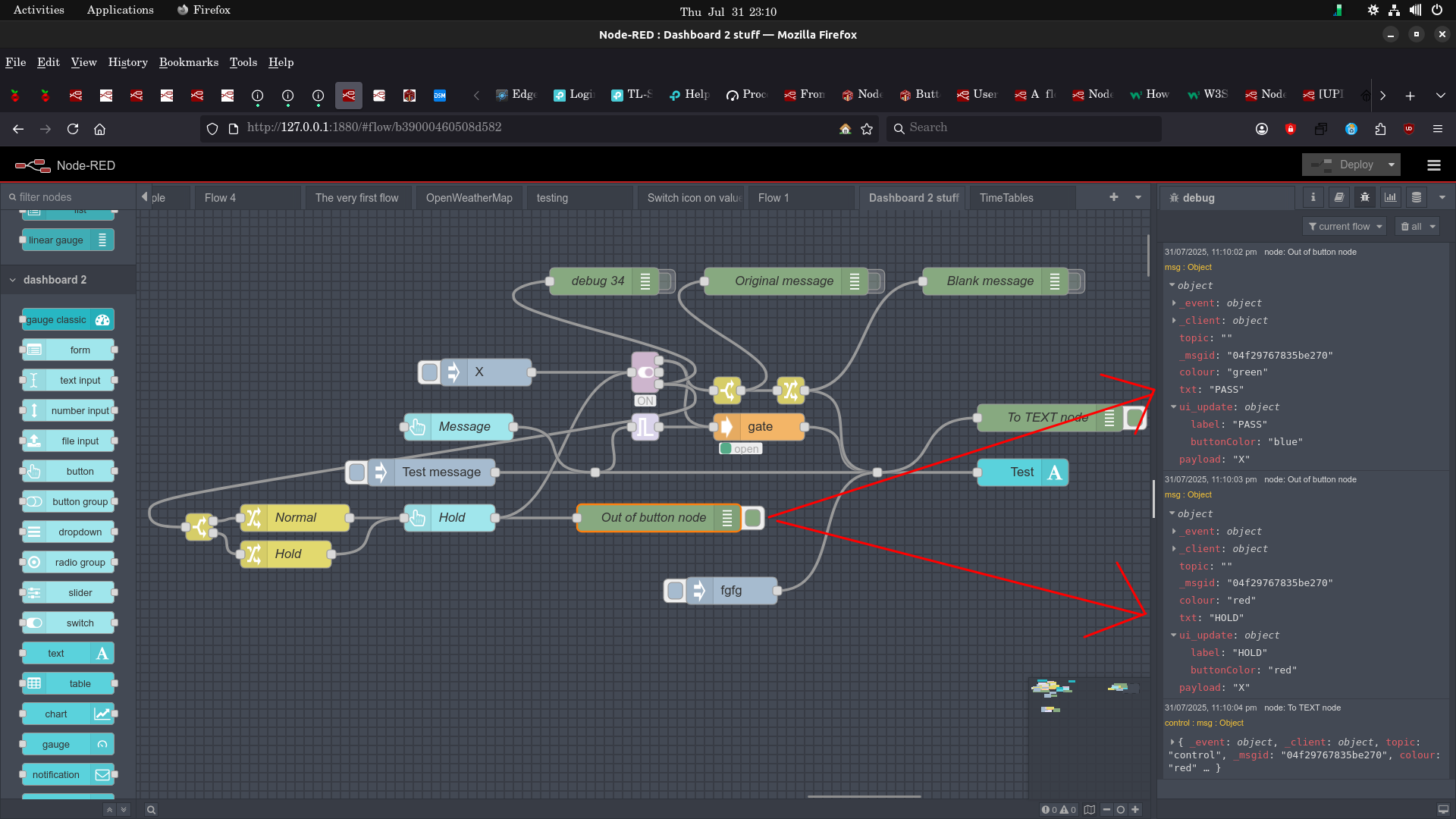

It is only for the node you send it to, but if you add a debug node showing what is going into the text node, set to Output Complete Message and you will see that you are see that you are sending it a message with ui-update.label set to HOLD.
But there is a PASS also in one of the change nodes.
And if HOLD gets sent, then PASS has just as much getting through as HOLD.
That's exactly what I did @Colin but I can't see how it gets from the output of the "Hold" change node to the input of the "Test" text node, because the button is not set to pass on incoming messages.

You appear to have found a bug in the Button node. It is passing on the msg.ui_update property that it previously received. Please report this at GitHub · Where software is built. Construct a very simple flow with just an inject, a button and a debug node. In the Inject node pass in msg.ui_update.label.
Woo hoo!
I found a bug!
Ok, I'll work on it.
I'm just fixing a change node to (I hope) stop it happening.
This does mean that you were not carrying out your earlier tests with sufficient care. You can work around the problem by adding a Change node after the button containing Delete msg.ui_update

If the button is sending msg.ui_update then it is a bug. It should not do that.

But - as you pointed out, I should check debug 4 too to see if the button is sending those things.
(Hang on)
Seems it s bug.

Because you are not setting msg.ui_update
In this simple flow
The inject sends payload and ui_update.label.
The button does not pass on incoming messages but it does retain msg.ui_update.
When the button is pressed, it sends the retained ui_update along with it's own payload.
Undoubtedly a bug!
