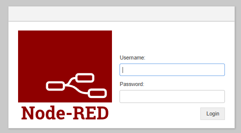

Is the user/pwd dialog that you are seeing the one that @smanjunath211 posted? If so then you can reset your password using the instructions at Securing Node-RED : Node-RED

How did you setup the user/pwd details initially?
Do you actually want to use a user/pwd to access node-red? If you are on a home network and do not allow access to node-red from the internet then you may not need to use a password. To disable password access edit the file settings.js in the .node-red folder and comment out the whole of the adminAuth section.

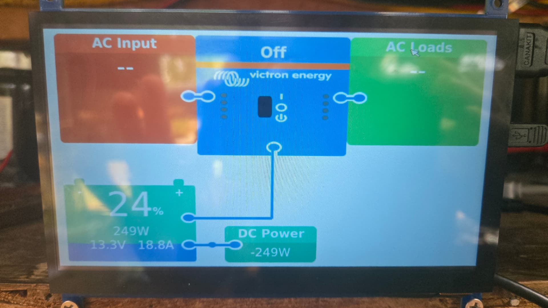

RaspberryPi 4b connected via USB from the BMS712 VE bus from a Victron Smart Shunt this connects into the raspPi with the VenusOS on the SD card. (which means programing is limited to stuff from Python and nano both limited programming with issues withing the VenusOS. Some folks on Github and Node Red are doing this kind of thing. But mostly I just cant get the Node red to give me a new pass word that is all.
But ultimately I have switch's that can be connected to the GIOP port on the Pi and get info into the VenusOS that it understand and can make into GUI buttons that can then be added to The GUI that is a controller for the my Solar system. Or I can control it Online via a portal on my Computer or via a SSH portal using the IP address and something like PUTTY that just another way to log in probably my tablet

The Unit refers to the RasperryPi that is next to the Battery and other components. I used a USB conect to a small screen that i can see the the Victron app. It is just small and hard to stand at even though it is just a few feet away in the Greenhouse section of the Shed. Which is a studio. also. The messy pic show the small screen the Pi the Shunt along side a couple of big Relays and switchs That are yet to be hooked up.

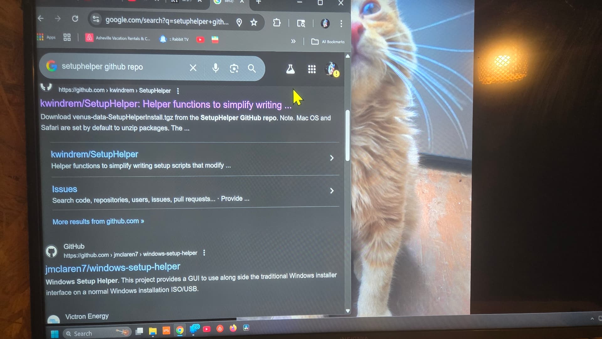

Sorry I had to go back in my history, I believe I used Setuphelper from a Github user kwend something or another. I have there name in the pic of my screen. But I also did an update from with the Nod red website I think? Sorry I did a few different things that may have conflicted passwords. Not sure I tryed to set up a PIN I believe and that may be the problem. I guess it is not as simple as just hitting a resset button on a page.

screen shot of a way to get to the Github user that has a setup that is easy to follow I am not sure how I messed it up but probably did not realize I had done it once than somehow set up a new account? not sure. this is responding to Colins question of how I got Node Red on my RaspberryPi. But through a program PUTTY which is a online protal I quess dont know the name. An also Yes only one Card can be in at a time but you can First put in the RaspberryPi SSD then VenusOS on a different card works as a program within the Debian OS or with enough that it acts like it? but I don't know how. Someone mention it is a NIX like a micro cornel or something. You can just put the Debian SSD card and do work within the RaspberryPi but you can also have the Venus OS SSD card in and then it works as a control center to my Solar system with a screen and key board or touch screen and the Victron app or Online portal that is. It is all varry confusing and I mess stuff or miss things. No excesses but I do have Dyslexia and that makes it hard to catch my own mistakes(kind of like color blind I cant even see it is wrong on the screen)

Install RPiOS on a new SD card with the Raspberry Pi installer. It lets you specify a username and password for the Pi.
Then login, update the OS and use the standard script to install Node-red. At the end it will walk you through setting a password for Node-red, and tell you how to set Node-red to startup automatically.
You can tell the Pi's IP address with the command ifconfig
Now point your browser to the ip address and port 1880 - in my case 192.168.1.28:1880.
You should see the Node-red login.
