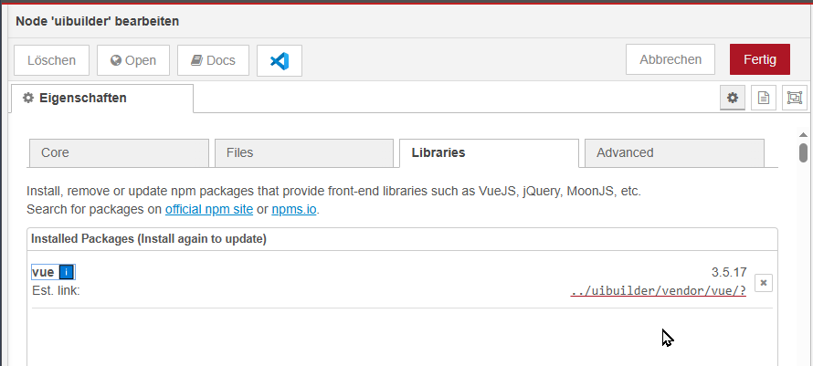

The uibuilder node here points to '../uibuilder/vendor/vue' folder, but after searching it in my entire /data folder neither a vendor, nor a vue folder is to be found.

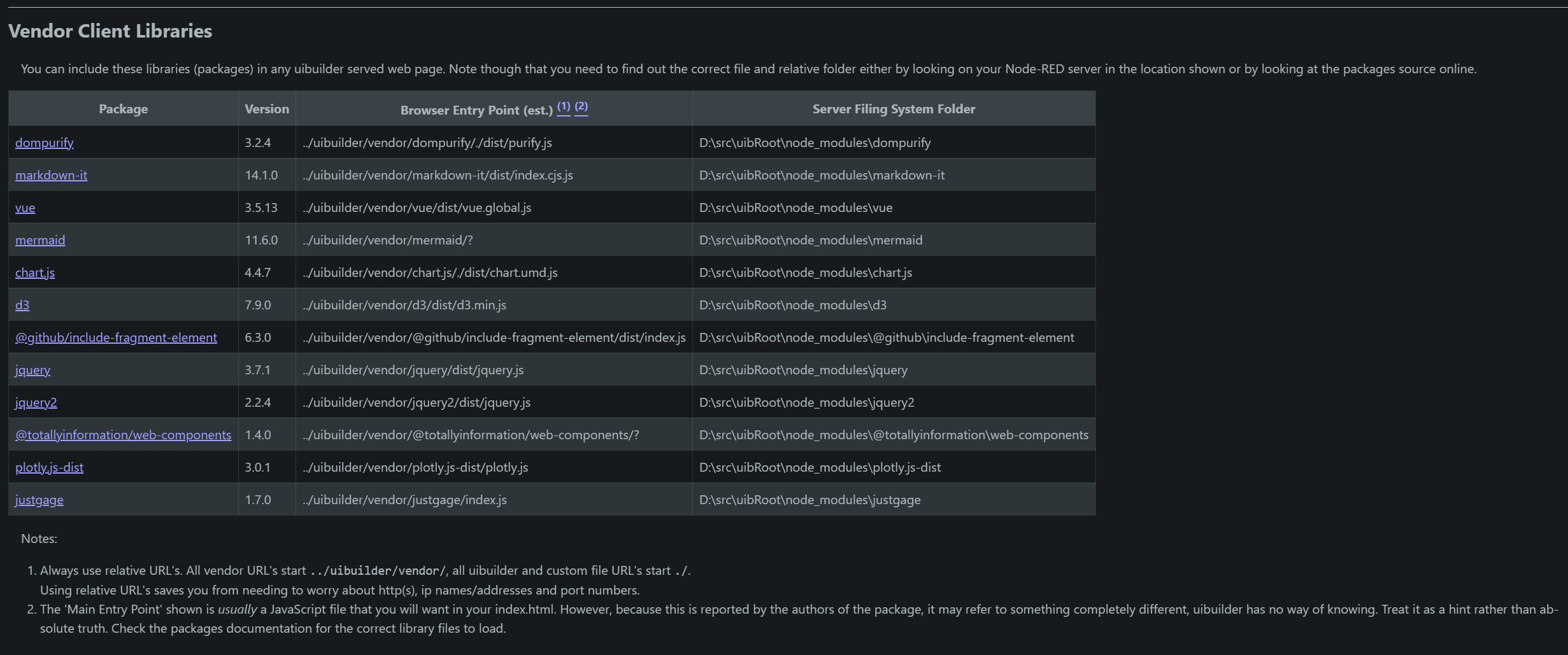

Front-end libraries are installed to the uibRoot folder which typically will be /.node-red/uibuilder/. So you will find the node_modules sub-folder in there and that is where the physical files live for any installed front-end libraries.
As it says on the library manager tab, uibuilder attempts to ESTIMATE the entry point for each library. However, many libraries do no correctly specify an entry point and so it is always a bit of guesswork and you may need to refer to the library docs to work out the correct URL reference.
Yup. The library manager runs npm behind the scenes, anchored to the uibRoot logical filing system folder. This keeps front-end libraries completely separated from any node-red libraries. The uibuilder module automatically mounts every installed library by adding an ExpressJS route to the <uibRoot>/node_modules/<libraryname>/ folder. So all the files in an installed library are actually accessible to the browser. Each of those folders is mounted to a URL: ../uibuilder/vendor/<libraryname>/. A relative URL is used because Node-RED has a lot of flexibility in how it can present itself in terms of URL's. Using relative URL's avoids all those issues.

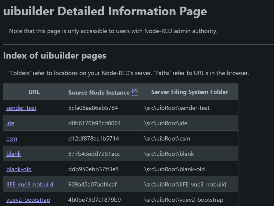

The "Full Details" web page shows all of the gory details about what ExpressJS web paths are mounted and where they point to in the filing system (amongst other details).
