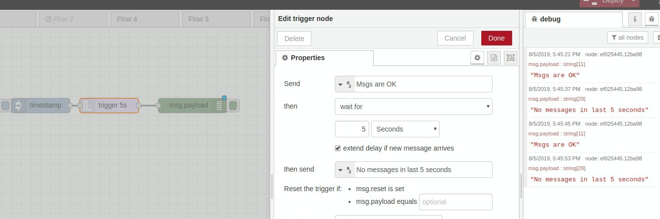

Try something like this
Msgs are OK gets sent on 1st message but it isn't sent again unless the node times out and then the messages start up again
Great. Works. This was not really obvious from the trigger node description (When triggered, can send a message, and then optionally a second message, unless extended or reset.)

I have the same requirement and have setup a trigger node appropriately. From the MQTT in node I can see messages coming in at 5 second intervals with a debug however because the data isn't actually changing (its a temperature sensor) the trigger node is not seeing them as new messages and timing out.
Any suggestions of a way to resolve?
Cheers
James
Do you have "Extend delay if new message arrives" ticked?
