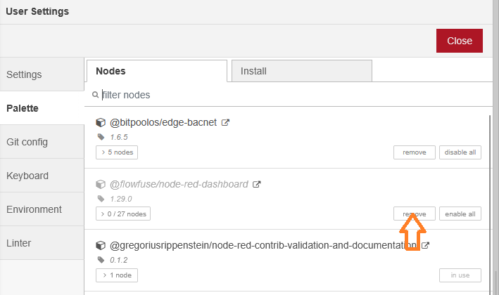

I click "remove":
And get this log:
2025-11-14T12:28:27.033Z Remove : @flowfuse/node-red-dashboard
2025-11-14T12:28:27.190Z npm remove --no-audit --no-update-notifier --no-fund --save @flowfuse/node-red-dashboard
2025-11-14T12:28:29.131Z [out]
2025-11-14T12:28:29.131Z [out] added 76 packages, and removed 55 packages in 2s
2025-11-14T12:28:29.139Z rc=0

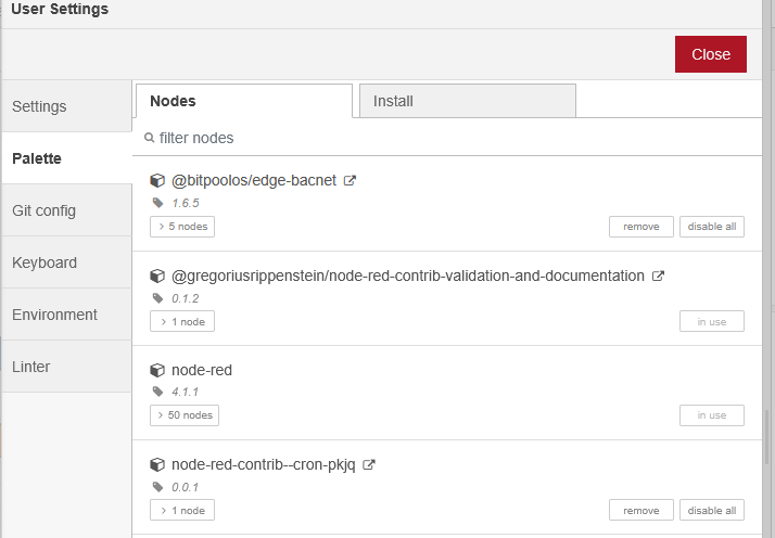

Palette doesn't list flowfuse dashboard anymore:

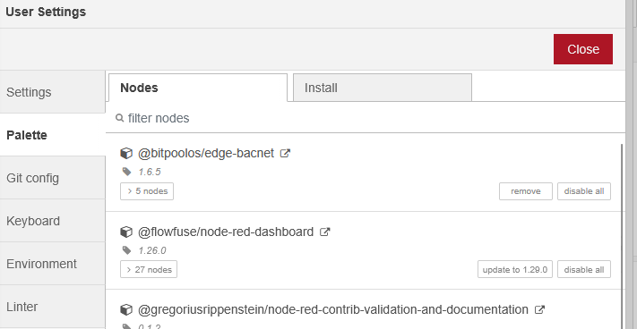

But flowfuse dashboard is back in palette manager:
If I updated it to 1.29.0, it gets added to package.json again and the cycle repeats.
Similar/same story for the other dashboard.
After uninstall, are the Dashboard nodes still available in the palette?
As I have documented with screenshow above, yes.
After remove, it is gone from package.json and palette manger (screenshot in previous post).
After restart, it is back in palette manager with the older version 1.26.0. However it is not in package.json. After upgrading to 1.29.0 it is back in package.json. I was tempted to remove it from .config.nodes.json too, however I suspect it might be auto-generated and so modifying it won't affect anything.
