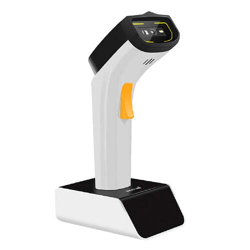

Are you just trying to decode barcodes ?
I recently did a project with barcodes and used this
They are wifi barcode scanners that sends MQTT... They work and makes things very easy!
